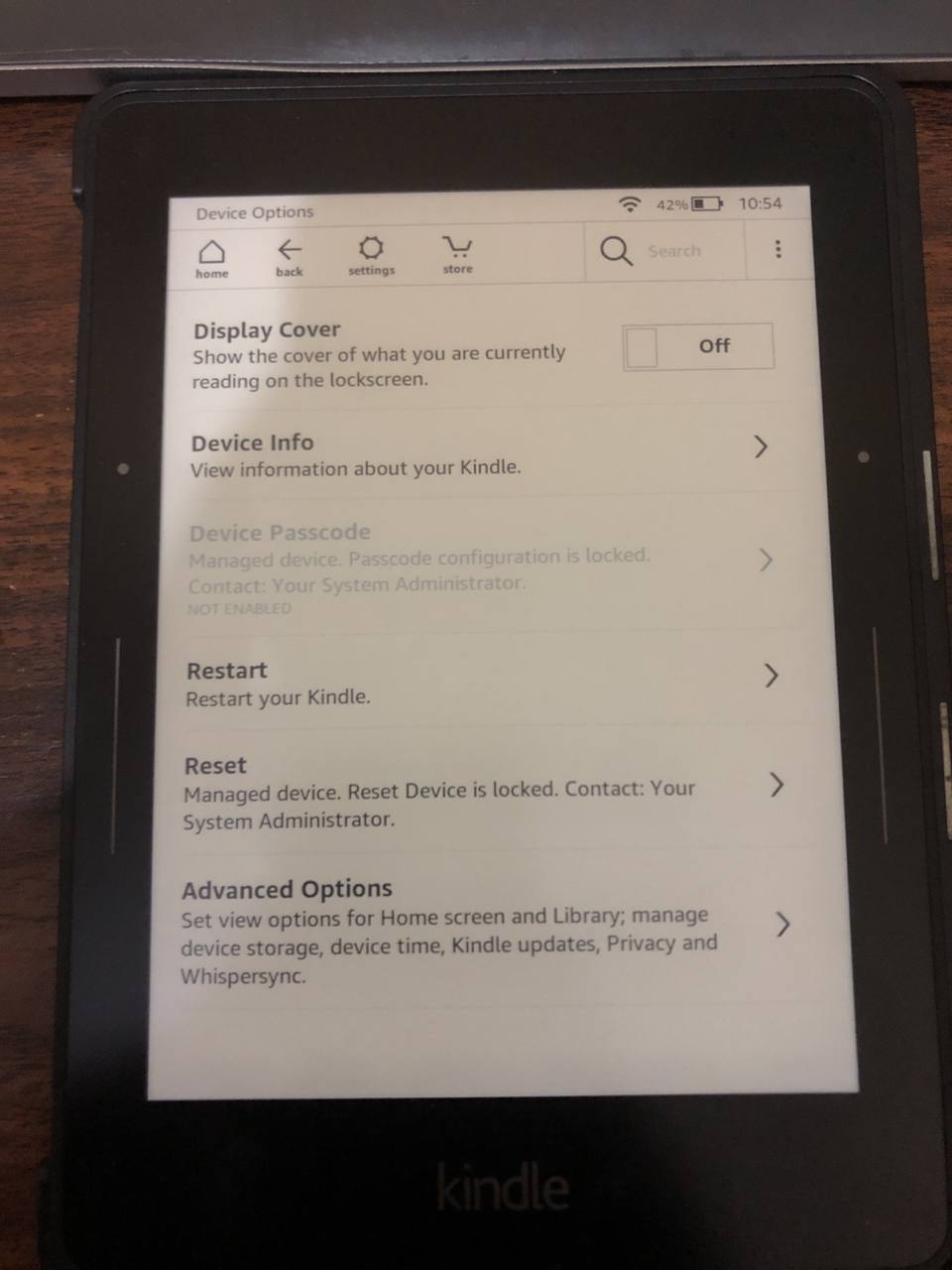

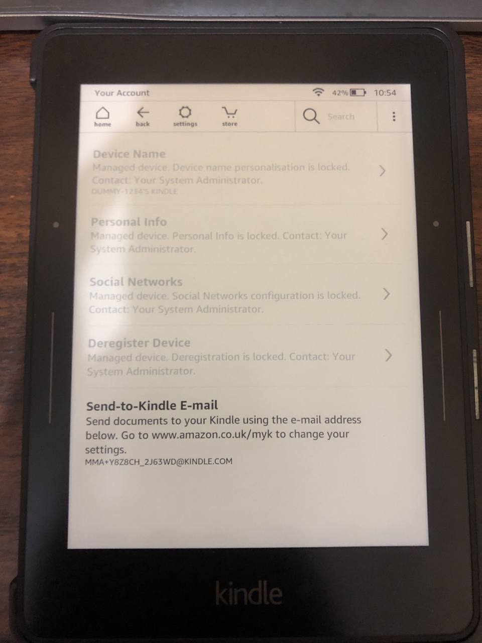

My KV is stucked in the ;demo mode and can't be reset
Please help me.
I was trying to Jailbreak my Kindle Voyage, My KV is at 5.13.6. I followed the process untill copying both KV-5.13.6 and demo.json and create goodreads directory under .demo
After that i was about to press "done" but the error occured, it is stucked in the demo menu and i can't click done. after that i connect the device to my wifi, and i hard reset the device.
and it's still stucked in the demo mode
I tried to put the latest firmware in the root of the directory, but again back into demo mode.
I cant reset the device because the reset button on setting can't be clicked, it said "contact: your system administrator"
Here i attatch the pictures

Totoro is offline   Reply With Quote
Old 08-28-2022, 07:57 AM   #732
Totoro
Totoro began at the beginning.
Join Date: Aug 2022
Device: Kindle Oasis 8th Gen & Kindle Voyage
Originally Posted by Totoro View Post
Please help me.
Sorry case closed. Previoulsy i thought i should creat empty folder name "DO_FACTORY_RESTORE" and because nothing happened, i tried to read the thread again and found out that actually i had to create empty file name "DO_FACTORY_RESTORE"
