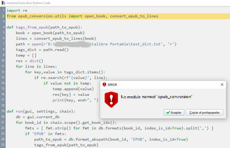

I created a python code in VScode that allows me to perform text searches within an epub book, these searches consist of matching the text of the book with regular expressions. These regular expressions come from patterns that I formulated for the tags in my library. I have already managed to get over 400 tags this way and I have a custom column for them, I add the @ symbol at the beginning to differentiate them from tags downloaded from other sources. I have 3000+ books and I want each of them to be attacked by these 400+ regular expressions.
I need help because my code only contemplates the search in a single book and what I want to configure is:
** Run the code on selected books from my library (books_ids).
** Found tags are added to the metadata.
** Add a verification tag confirming that the book was processed.
The truth is that my knowledge of python is very poor, I only learned about regular expressions thanks to Calibre.

Thanks for the answer for both Senseis , but I have a little problem I have Calibre Portable on Windows 7 where version 3.48 is the latest. Action Chain requires version 5.25.0 or later. Do you know of any previous version that is compatible with Windows 7?

I followed the recommendations but I'm having trouble reading the content of epubs.

You need to have a Python module called "epub_conversion.utils" available to you. You have that in your original script. Where is it coming from? It does not look like a calibre module and I cannot find "convert_epub_to_lines" in the calibre source. You will either need to add this module so that you can see it when running in calibre. Or change the code to use calibre functions. I know the Count Pages plugin does this (extract the text from an epub), so you can look at that for how to do it.
I wrote the code initially just for an epub book in Visual Studio and it worked for me. Applying code with Calibre functions is another multiverse, that's why I need help putting it in the context of Calibre.

Calibre comes with its own copy of python. As such, you cannot (directly) import modules from your system python. You have two options:
  • Follow davidfor suggestion and develop your solution using code from calibre libraries.
  • Modify sys.path to include the path(s) from which you want to import the original module. You can search the forum for examples. I am not sure what adverse effects this might lead to, as I have never done done it before. So, you have to research this yourself.

RE_HTML_BODY = re.compile(u'<body[^>]*>(.*)</body>', re.UNICODE | re.DOTALL | re.IGNORECASE)
with open("test_dict.txt", "r") as f:
    tags_dict = f.read()
def _extract_body_text(data):
    '''Get the body text of this html content wit any html tags stripped'''
    body = RE_HTML_BODY.findall(data)
def tags_from_epub(path_to_epub):
    temp = []
    res = dict()
    for line in _extract_body_text:
        for key,value in tags_dict.items():
         if re.search(rf'{value}', line):
            if value not in temp:
                temp.append(value)
                res[key] = value
                regex = re.compile(value)
                match_array = regex.finditer(line)
                match_list = list(match_array)
                for m in match_list:
                    print(key, ":",m.group())
def run(gui, settings, chain):
    db = gui.current_db
    for book_id in chain.scope().get_book_ids():
        fmts = [ fmt.strip() for fmt in db.formats(book_id, index_is_id=True).split(',') ]
        if 'EPUB' in fmts:
            path_to_epub = db.format_abspath(book_id, 'EPUB', index_is_id=True)
Well, you get that error because you didn't actually call the method. "_extract_body_text" appears to be a method that takes a string of some sort. But, when you used it, you treated it as something else.
And that doesn't look anything like what Page Count does. It will open the epub as an iterator, then iterate through the files in the spine, extract the text from each of them and combine them into a big long chunk of text. Then it process that. You have passed "path_to_epub" into your method, but, never actually used it. From the Count Pages plugin, you need to look at statistic.py and follow the flow starting with "get_word_count"
