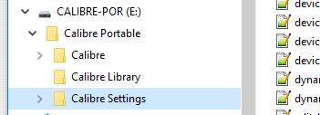

Where was Portable installed? There was a setting folder in the root folder of the install.
Portable (and Calibre Windows) do not use the registry for settings.

Calibre (both regular and portable) does store all settings in files; not the registry.
Portable is really intended to be installed on a removable storage device (USB drive) which can then be moved computer to computer.
Regular calibre stores it's settings in the %AppData% directory, while portable uses a directory under the location it's been installed in.

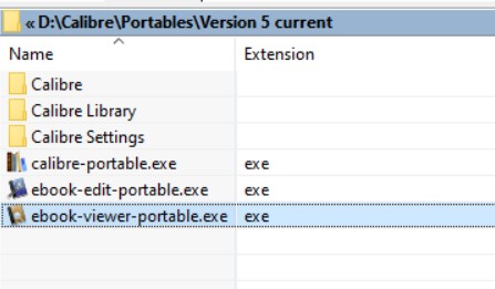

Installing Version 5 Portable should result in something like this:
You should run the three *-portable.exes directly, or via equivalent shortcuts.
Previous versions did not have *-portable.exes for the viewer and editor.
