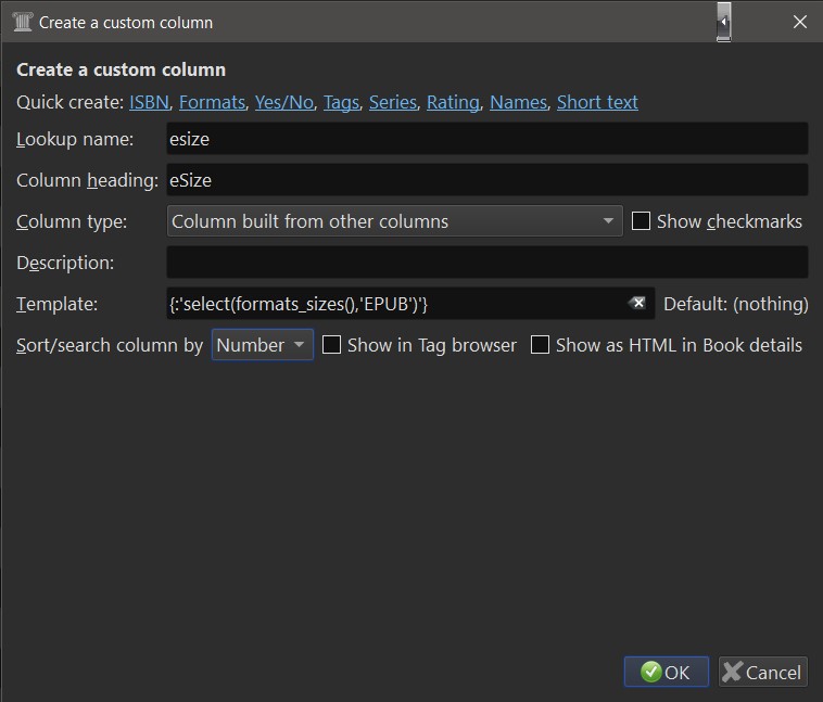

Plugin idea - Size per Format (or can I do this with Custom columns)
Hello,
I tend to keep multiple format of the same book. I added the "size" column, but
it does not show me what is the size of each format, and I have to keep opening the location of each book.
It would be useful to be able to ask to see size of a specific format only.
(it may be this is already doable w/o a plugin - I started to look at the
template language, and specifically conditional templates - has anyone done this or can offer any advice?)
Thanks
(I have searched, and did not find a previous discussion of this.)
Orr101 is offline   Reply With Quote

Originally Posted by Orr101 View Post
Hello,
Thanks
You can get a list of the sizes via the formats_sizes template function, see ==>> Reference for all built-in template language functions
e.g a column like so:
Name:	Screenshot 2022-01-06 204050.jpg
{:'select(formats_sizes(),'EPUB')'}

Tenome - Thanks a lot. I had a feeling the templates were something to try, but I had managed to get a "template error" each and every time ...
Thanks for the help

It is there, but it is not on the surface (spreadsheet)
In the Metadata Edit window: The size is shown next to the format (name)
I was looking for a way to see it in the main window. It turns out that using Template programming language you can add a column per format, and also make size per format show up below the Cover picture
