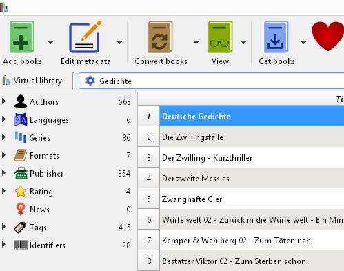

Is there a plugin (or maybe even a setting) where I can put the normal search (through my library) in Calibre incremental?
It is not a big thing, but I am so used to incremented search that I miss that feature in Calibre. Could be not that difficult, or?
Thank for hint
frank
EDIT: see attached Screenshot where it is in Calibre, what I mean. In my example the list schould be diminuished to only Titles with "Gedichte" containing.

If I understand correctly this is already implemented:
In Preferences >Searching select search as you type.

Thank, I just didnt noticed that
Works
