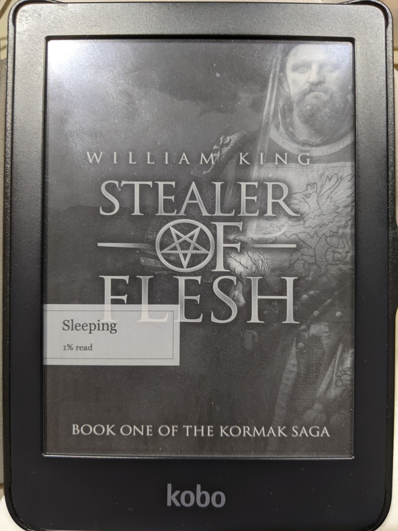

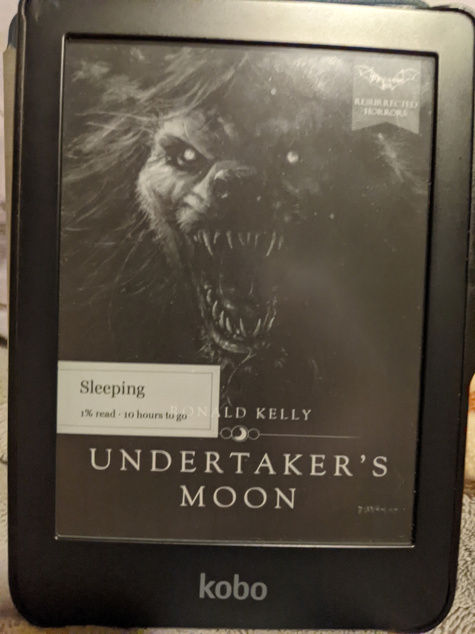

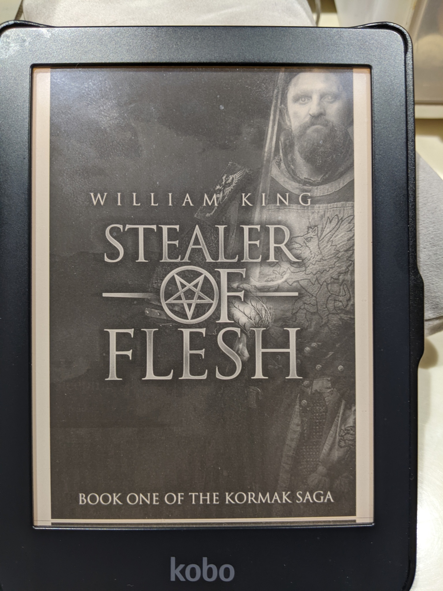

For sideload kepubs, the image to be used as a cover is marked in the OPF. The device will extract the image and resize it as needed. It does not change the aspect ratio. That means when it is displayed on the sleep screen, it is shown with with borders unless the cover is the same aspect ratio as the screen.
I have many (most?) books on my Clara where the aspect ratio doesn't match the screen. When I open the book, the cover will be letterboxed or pillarboxed. But on the sleep screen the cover is stretched to fill the screen. See attached for an example. (Please forgive the glare and slight fisheye I always get when taking a close-up picture.)

I have many ( most?) books on my Clara where the aspect ratio doesn't match the screen. When I open the book, the cover will be letterboxed or pillarboxed. But on the sleep screen the cover is stretched to fill the screen. See attached for an example. (Please forgive the glare and slight fisheye I always get when taking a close-up picture.)
Interesting. I just tried it, and my sideloaded kepub was pillarboxed on the sleep screen.
And in addition to % read, it also shows time remaining. I am on a newish firmware.
I'm on 4.30.18838.
In Settings/Energy saving and privacy, I have Show current read, Show book covers full screen , Show info panel on full screen covers all checked.
Show book covers full screen is probably what is different between you and me. Is yours checked?
Any guesses as to why ZodWollop's isn't showing time remaining? Maybe because he hasn't gone past the cover page?
Maybe. The book in my example was one I opened because I knew the aspect ratio was different.
I use a sleepcover and don't usually see the sleep screen. Let me open the book I'm about to start and flip a few pages in to see if it shows time remaining...
Edit: As per the attached, looks like you are right.
