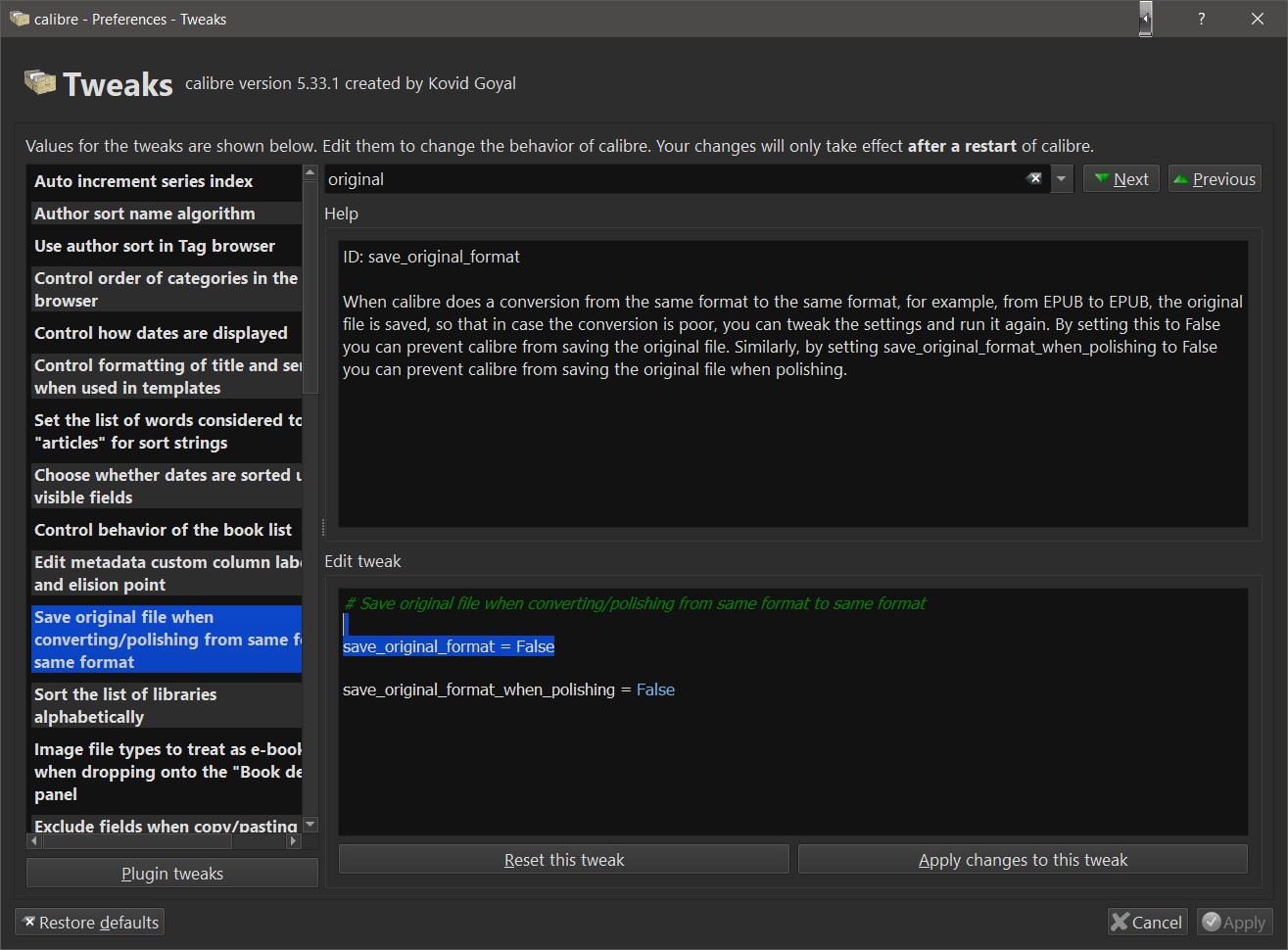

Hello!
When I do conversion, is it so that the conversion is every time done from the original file? So if I mess up conversion and redo it with correct params, the output is a conversion from the original file?
artekxp is offline   Reply With Quote
Old 12-15-2021, 06:10 AM   #2
Posts: 22,394
Karma: 31000056
Remove the ORIGINAL_xxxx format file
If you would rather not have ORIGINAL_xxxx format files adjust this Tweak:
Name:	Screenshot 2021-12-15 210821.jpg

This tweak is the solution I'm after so that I can mess up epub -> epub conversion and redo it again and again because I want to use the original epub as the source. Thanks!
Just to be clear, that tweak is to turn off the creation of the ORIGINAL_EPUB format when doing a conversion. From your description, the default behaviour, that of creating the ORIGINAL_EPUB format and using that format for future conversions, is what you want. Or had you changed this before?

No the setting was already in default setting so I was safe to do re-conversion from get go.
