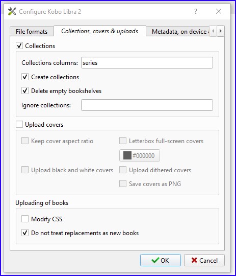

Hello @davidfor and thank you for this plugin.
I am setting up my Libra 2 and trying to ensure my Series are uploaded correctly. The series are uploaded and displayed in the device library, but the books are not in the order as shown in Calibre.
In Calibre I use the default Series/Number fields to order books in the series. When I transfer to Kobo, the order is not transferred. I have used the "Manage series Information in device library" option and can order the books there.
My questions are:
1. Can I automatically transfer the order number when the book is sideloaded. If yes, what setting do I need to change in the image?
2. I have tried to Lock the series order, but the lock does not seem to hold. I get "0 books updated" and when I reenter the manage series screen, the lock icon is not there. Are there situations where this is expected not to work?
Thanks

Series is now independent of collections (you don't need the later)
Try the plugboard to insert series_index into the Title
{series_index} - {title} -> {title}

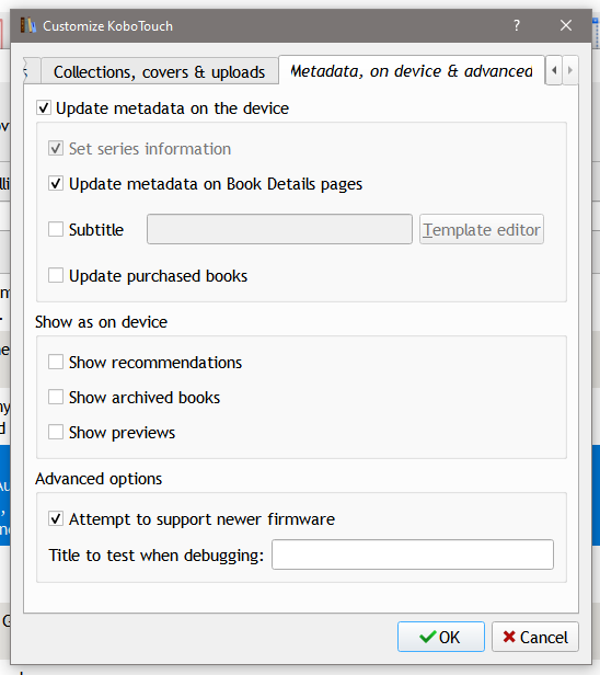

Thanks
What theducks said. Here's how my KoboTouch is configured. Note the grayed out "Set series information". It becomes selectable if I uncheck "Update metadata on Book Details pages".

No, you do not need to do that. The Kobo devices actually understand series info and treats it as such. The series name and index are stored in the database. They are displayed in the list and used for sorting. If you do the above, then the device will treat each book as a being in a separate series. I think the only reason to fiddle with the series name is if you want to adjust if for some reason. Length or putting "The" on the end are probably the main reasons. But, I'm pretty sure the device does the latter when sorting.
The only issue with this is that the device does not read the series metadata from the book when importing them. You need to connect to calibre again to update the metadata for this to happen. After that connection, the series information will be displayed. There is also some hidden stuff happening for the series list and sorting there. But, the driver takes care of that.
