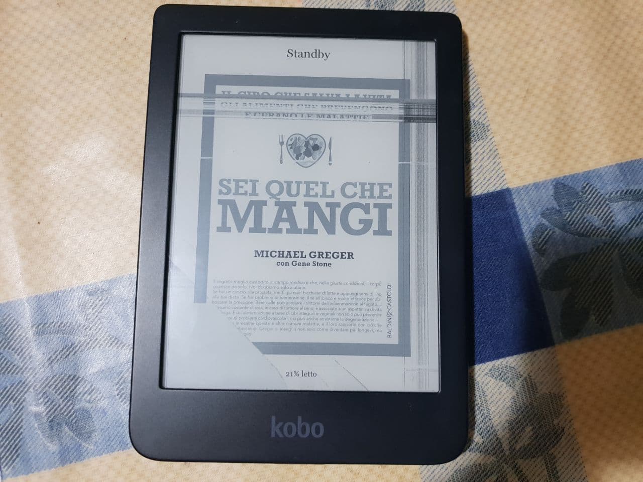

Screen or mainboard broken?
Hi davidfor, thanks for the link.
Unfortunately the image (written on another MicroSD), hasn't solved my issue.
The Kobo is always stuck on a book cover with some vertical and horizontal lines (i put an image of the kobo).
How can i understand if the screen is broken, or the mainboard is broken?
I saw a spot on one chip of the mainboard of the Kobo Clara HD, and i suppose that the chip is burned, but i'm not sure about this.
Thanks again for your time.

Diagonal artifacts are pretty typical of a broken substrate, as it's literally a cracked corner of glass.

Dear NiLuJe, thanks for your reply.
I used the kobo with the original Rakuten case.
It is possible to break the screen with the kobo inside it?
Can i do some tests to ensure that only the screen is broken?
I found the replacement screen on aliexpress (about 65 €), but i want to be sure that only the screen is broken.
Thanks for your support.

Hard to say without opening it up .
