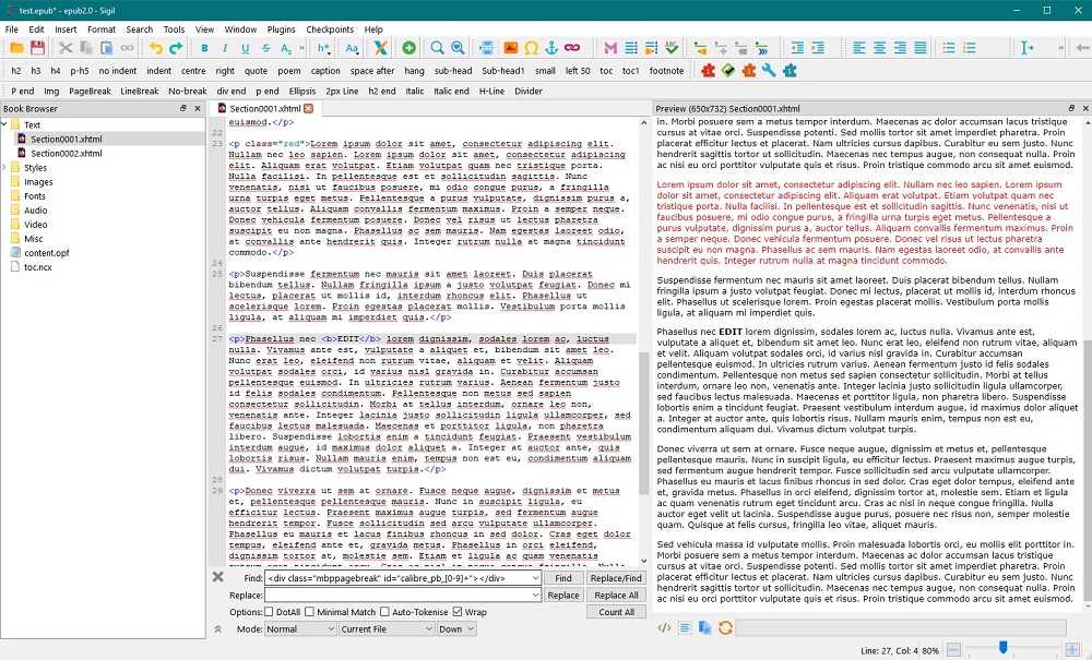

That's puzzling as I can't replicate Becky's findings.
I always have my preview window set to 80% and the synch between code and preview when editing the code works as expected for me.

@Ashjuk: Are you sure you have the 80% preview window?
The zoom is independent for the Code View and the Preview window.

The same zoom control works for both. So click in Preview after it loads and then move the zoom slider and it should only zoom the Preview.

Yes. I have the preview set to 80% and the code view to 100%. Depending upon which window I have clicked the slider changes to reflect my setting.
If you look at the images I attached to my last post you can see the slider is at 80%.

It depends on the length of the file and where you are IN it as well. If the edits you're making are close enough to the top (or bottom) of a relatively small file, it's possible for the recent edit to still remain visible in the Preview Window even after the incorrect sync attempt. Try a good long xhtml file and scroll to the middle of it and see if that makes a difference.
I can see in the original images you posted that you're scrolled nearly to the bottom of the Preview Window. And that although the sync is still being botched after your edit, it's just not moving the needle enough to make a huge difference.

@Ashjuk: So how did you take your screenshots when we see Zoom 80% there? This can only be seen after clicking in the Preview window.
If you click on the Preview window, Code View synchronization will occur, and the problem we are discussing is Code View reverse synchronization -> Preview Window.
If you really have Code View 100% and Preview 80% then click on the red paragraph in the Code View and in the Preview window it will not be in the center, but a little above the center.
