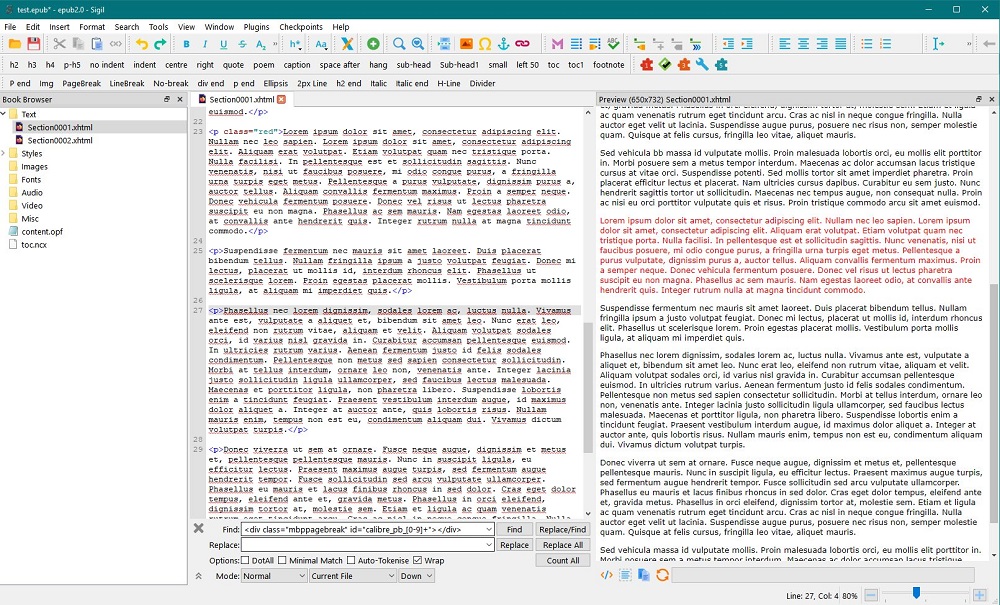

That's puzzling as I can't replicate Becky's findings.
I always have my preview window set to 80% and the synch between code and preview when editing the code works as expected for me.
https://www.mobileread.com/forums/at...1&d=1627919338

@Ashjuk: Are you sure you have the 80% preview window?
The zoom is independent for the Code View and the Preview window.

Yes. I have the preview set to 80% and the code view to 100%. Depending upon which window I have clicked the slider changes to reflect my setting.
If you look at the images I attached to my last post you can see the slider is at 80%.
The same zoom control works for both. So click in Preview after it loads and then move the zoom slider and it should only zoom the Preview.
I discovered that some time ago, as I just said to Becky, I have code set to 100% and preview to 80%.
Just a little puzzling that the 'bug' does not seem to affect me despite my having the preview window zoomed out.

@Ashjuk: So how did you take your screenshots when we see Zoom 80% there? This can only be seen after clicking in the Preview window.
If you click on the Preview window, Code View synchronization will occur, and the problem we are discussing is Code View reverse synchronization -> Preview Window.
If you really have Code View 100% and Preview 80% then click on the red paragraph in the Code View and in the Preview window it will not be in the center, but a little above the center.
