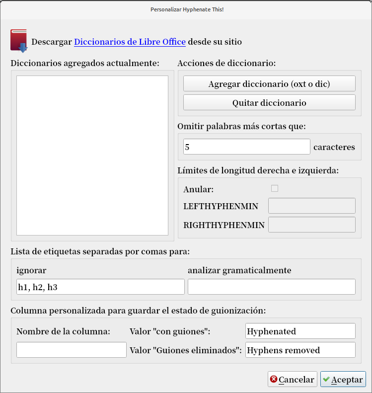

At the request of some friends I have translated the complement into Spanish. I hope it can be incorporated into the next update if they deem it convenient. I leave the file
