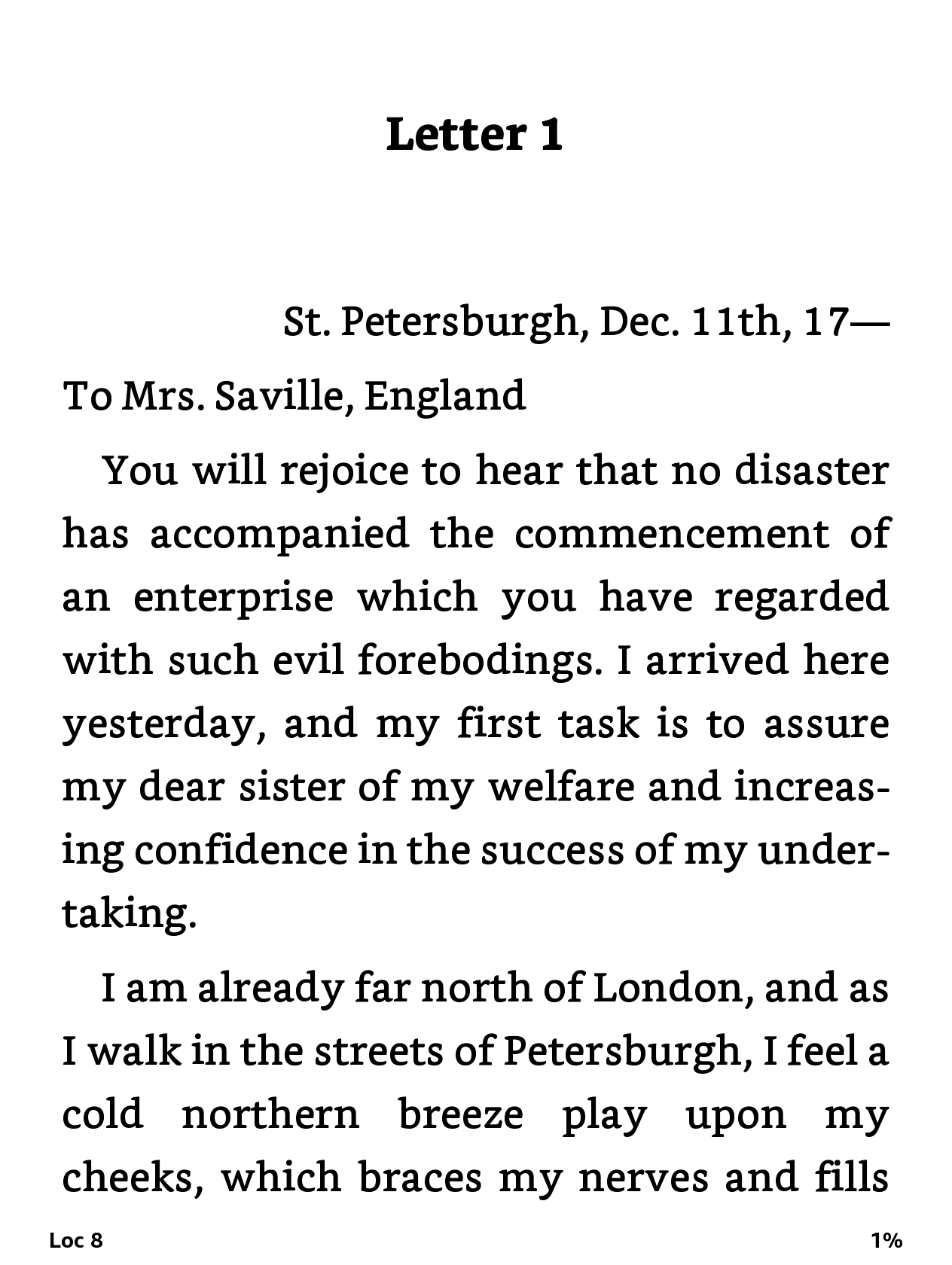

I tried this plugin just now on this English language book using calibre 5.23.0 and it worked for me. I was able to add soft hyphens to a book in AZW3 format, sideload it onto my Kindle Oasis running firmware 5.13.6 and see the expected hyphenation.
Perhaps you could try the same book and see if it works for you. If not you should check for any errors in the job log. If none you could post the resulting AZW3 file and so that someone can check it for the presence of soft hyphen characters.
I also tried the "Add soft hyphens" function of the built-in Polish Books feature of calibre and that worked too. You could try that as an alternative to using this plugin and see if it works instead for you.
Another possibility is to convert to KFX format using my KFX Output plugin. That does hyphenation automatically as part of Amazon's Enhanced Typesetting.
Added: If you are really running calibre 5.13 and that wasn't a typo then I suggest you update.
