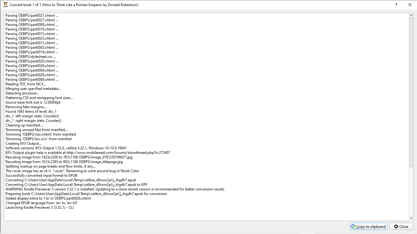

Conversion is stuck at 67%
Whenever I try to convert a book it gets stuck at 67%. This started happening after I updated the plugins. Can I get the old plugins or is it something else causing the problem?
From the log it appears that the Kindle Previewer is failing to launch. Some possibilities are anti-virus software blocking it or a bad installation. I suggest that you try disabling your AV and removing/re-installing the Kindle Previewer.
If neither of those solve the problem and you know which version of the plugin you were running previously then I can re-upload it for you to try, but I doubt that will be of any help.
Note: This question and answer relate to the KFX Output plugin, not KFX Input.)
