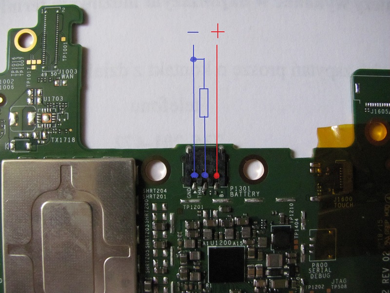

Is it possible to limit battery charge to say 80%?
In my rooted Android devices I have faithfully adhered to limiting charge between 30-80%. Probably that's why even after 4+ years in 2 of my oldest devices (2 & 3 years of intensive usage) battery health is still in the 85-90% range and they still deliver 8-10 hour SoT. Considering the difficulty in obtaining a replacement battery for Kindles in my country I would like to prolong the battery life as far as possible. After jailbreak I have no desire to get an Android based one.

Nope. But the PMIC will take care of that for you anyway (roughly speaking).

Once the PMIC decides the battery is charged, the current to the battery stops and the kindle is powered from the charger. There are numerous inexpensive USB power meters that display voltage, current, and sometimes more. Some information is available from the kindle in /sys/class/power_supply/max*battery/

Originally Posted by atonement View Post
P.S. For some older Kindles there was a software mod to boot the device without a battery. Does that still work for newer devices in particular the PW3?
The Paperwhite 3 starts without problems without batteries. Just add a 100k resistor pretending to be a temperature sensor. This applies to all kindle with 3-pin batteries.

I haven't seen a tutorial for this anywhere. Just connect it like in the picture. Resistor ~ 100k, power supply max 4.2V.
