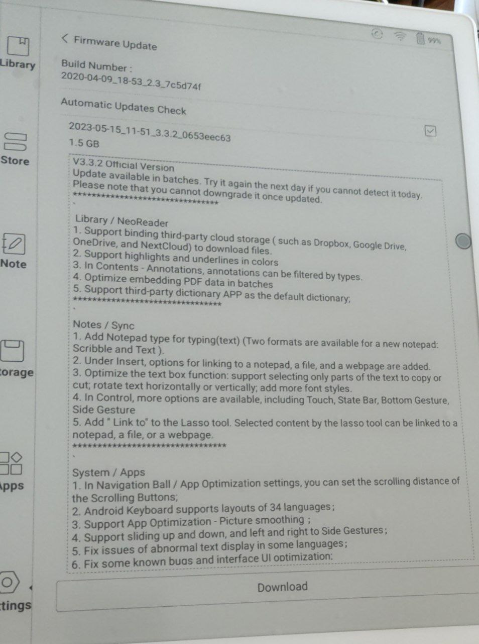

Hello diabl0w, I read about your instructions to flash TWRP, so after months/years I have turned on my max3 again, and I have seen that there is a new update (v3.3.2) 2023-05-15_11-51_3.3.2_0653eec63. I don't know if you are aware of this new update and I wanted to know if your instructions are still valid to this new version.
The changelog is in the attachment or it may be seen it here https://imgur.com/a/ckfJzZ4
