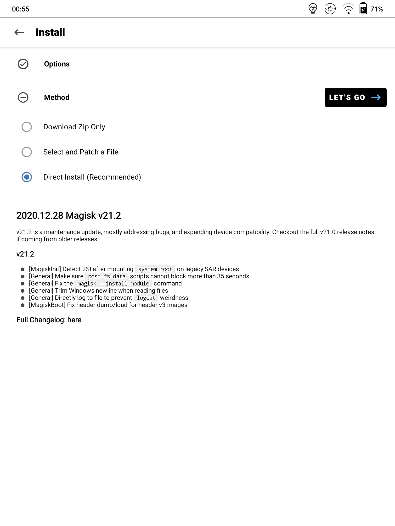

[7] Start Magisk Manager and use "direct install" method to install boot image with latest magisk version.

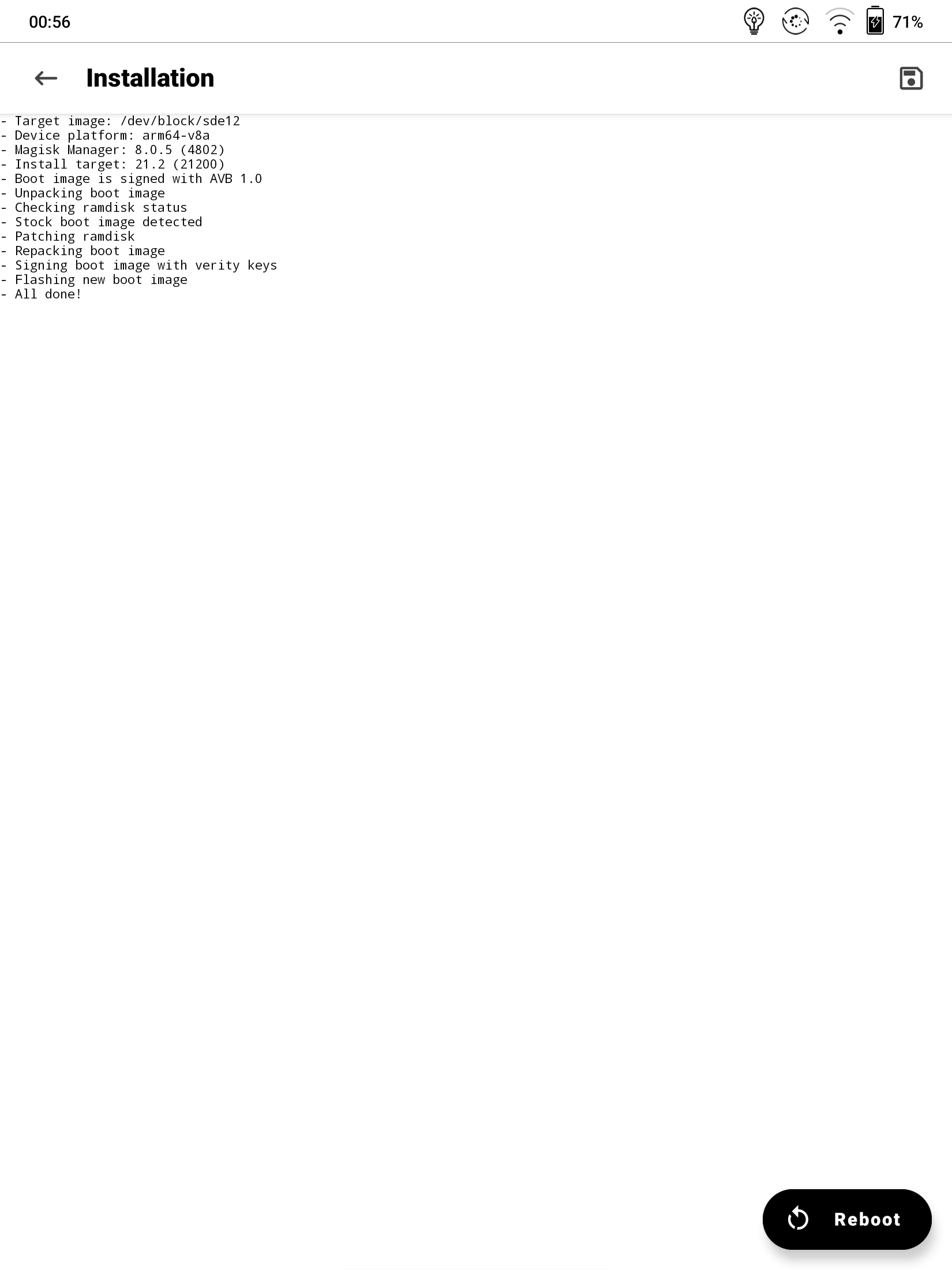

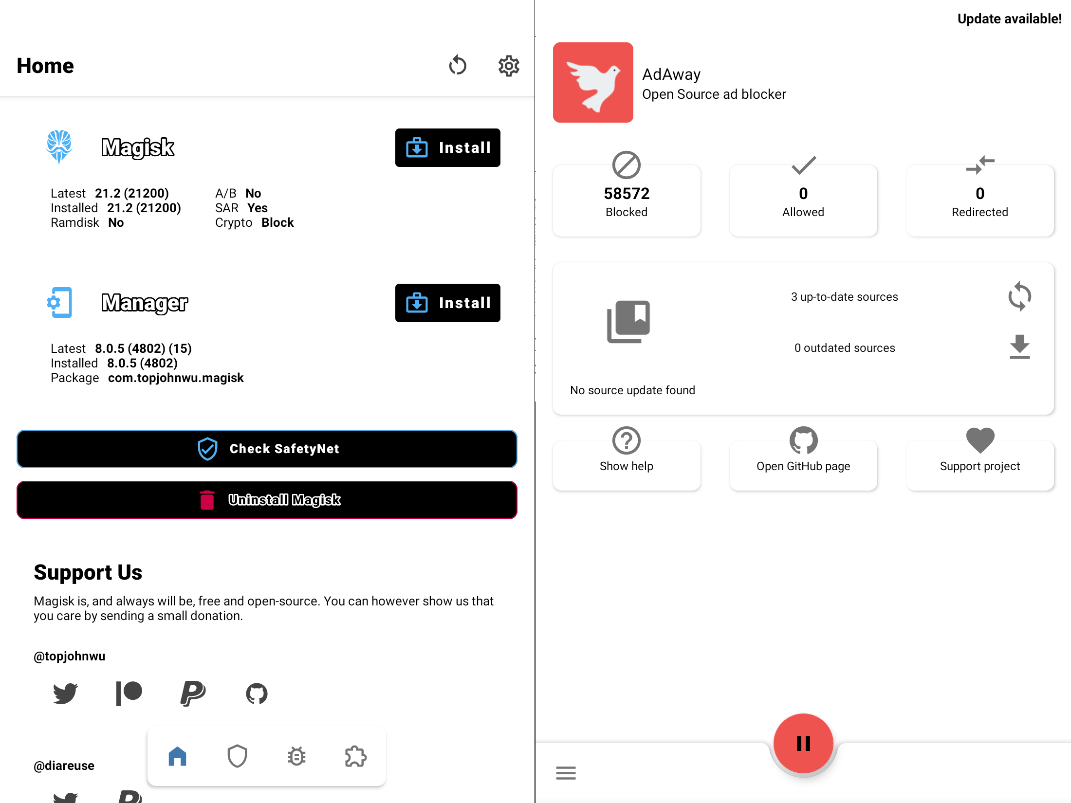

#1 Magisk Manager on rooted Max Lumi with AdAway app in Split Screen mode
#2 & #3 Magisk Direct Install
