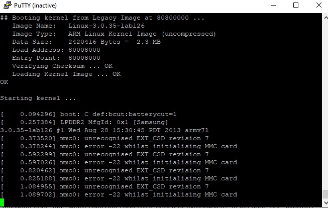

In my pw2 4GB the emmc memory was damaged. On the occasion of the exchange, I decided to increase its capacity. I put on a samsung 8gb chip. I set the serial numbers without any problems, uploaded the main kernel and diags, and the diags system. Unfortunately, the kernel won't boot. I have the message: mmc0 unrecognised EXT_CSD revision 7. Can there be any workaround?
Can the situation be saved by compiling the kernel? I will be grateful for your help.
Maybe some clues here?
https://github.com/embeddedarm/linux...e98984742f3d07

It turned out that I had to get the kernel from some very old version of the software. Newer kernels have this already encoded by Amazon.
Thank you and best regards!
