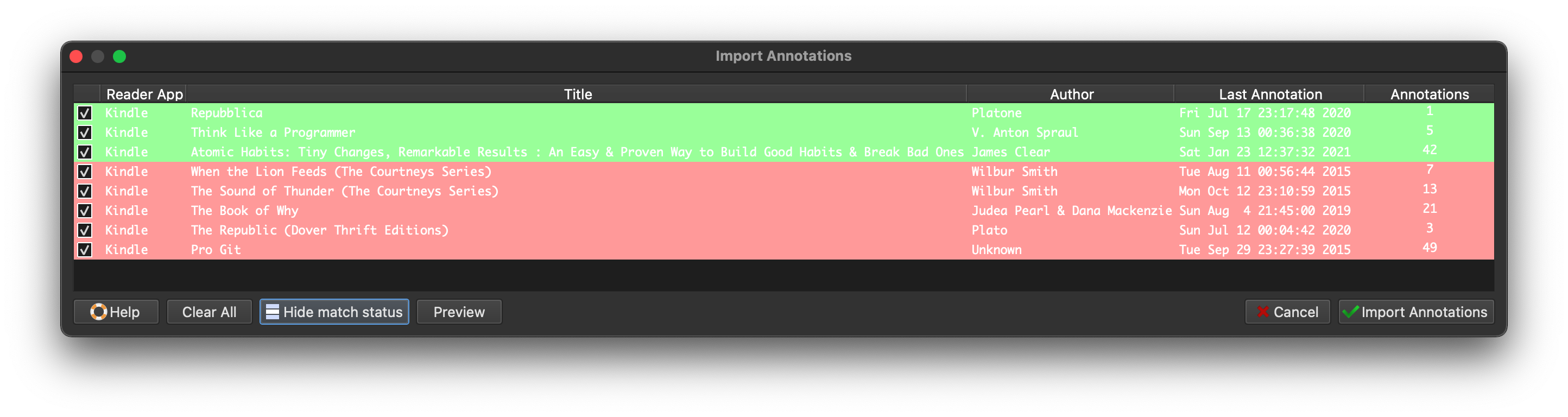

Attachment 184991
That looks good. But, it also says that you have only three books on the device that match to books in the library (have the green tick next to them). And the other five books that have annotations don't show as matched. Is that correct?
If so, you can fix this in the device view. Right-click (or whatever the equivalent on a MAC is) on an unmatched book and choose the "Match book to library" option. On the dialog that comes up, search for the book, select it and press OK to update the list. When finished matching them, right-click the device button and choose "Update cached metadata on device". This will update the metadata.calibre file on the device and calibre will match the book to the library in the future.
Log: Attachment 184990
That's horrible. If you click the "Hide match status" it will use the default list colours and should be more readable. Someone did report this a few weeks ago and I said I wasn't interested. I thought the posted a version of the plugin that did something different with colour, but, it was removed before I had a chance to look at it. I don't know if it simply set colours that were better for dark-mode or did something else. I have to do something for colours in another plugin, so I might visit it here when I have done that.

That looks good. […] Is that correct?
Yes. The others are Amazon's Kindle books, and their annotations can already be exported through Amazon's system.
I was trying to dump the annotations for Atomic Habits only, which I've sideloaded, and therefore wasn't showing up on Amazon's system. (I wonder if it would have shown in case I would have sent the book to my Kindle via email rather than USB. I guess we'll never know.)
That's horrible.
I agree.

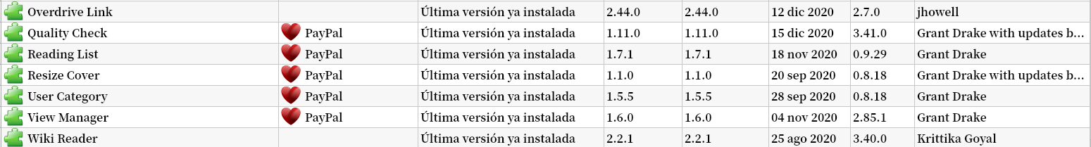

@davidfor
Apparently this latest beta solved the export problems, of the books added through the cable and through the mail, the marks and notes are added to the file My Clippings.txt.
My plugins are all updated to the latest version so I will check the errors that you tell me. Thank you very much for all your answers and I will see to complete the translation of the plugin into Spanish, which in my opinion is 50%.
