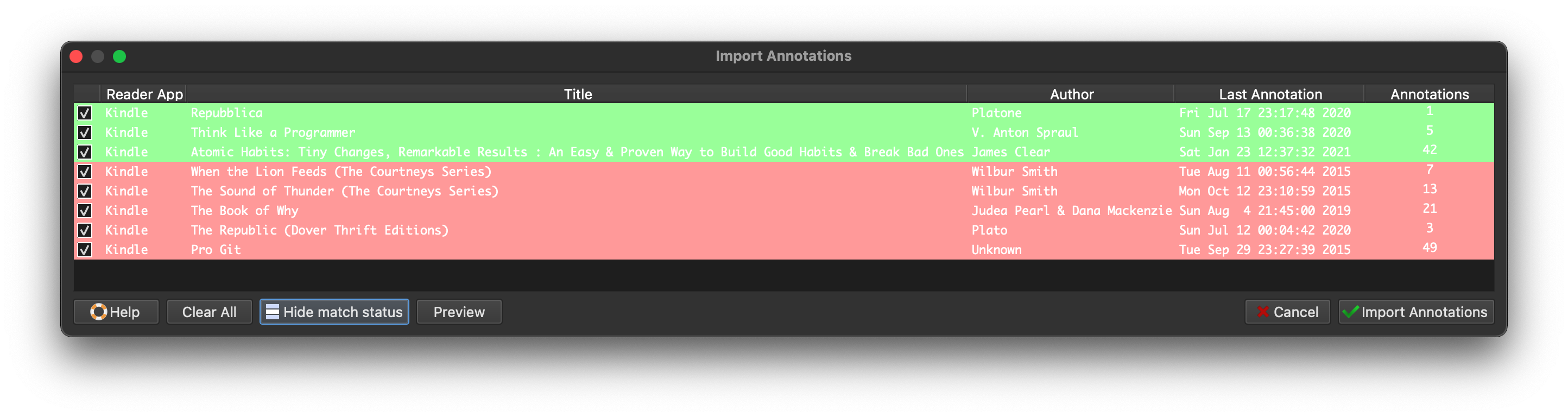

Awesome! I cannot see anything, but it works!
Attachment 184991
That looks good. But, it also says that you have only three books on the device that match to books in the library (have the green tick next to them). And the other five books that have annotations don't show as matched. Is that correct?
If so, you can fix this in the device view. Right-click (or whatever the equivalent on a MAC is) on an unmatched book and choose the "Match book to library" option. On the dialog that comes up, search for the book, select it and press OK to update the list. When finished matching them, right-click the device button and choose "Update cached metadata on device". This will update the metadata.calibre file on the device and calibre will match the book to the library in the future.
Log: Attachment 184990
That's horrible. If you click the "Hide match status" it will use the default list colours and should be more readable. Someone did report this a few weeks ago and I said I wasn't interested. I thought the posted a version of the plugin that did something different with colour, but, it was removed before I had a chance to look at it. I don't know if it simply set colours that were better for dark-mode or did something else. I have to do something for colours in another plugin, so I might visit it here when I have done that.

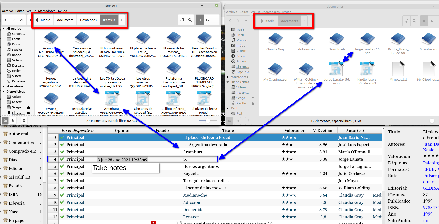

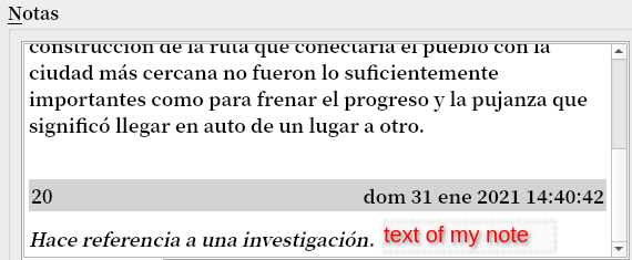

I have managed to make the plugin work, with the following criteria. If the book is passed through Cable from Calibre the file is housed in documents and if in that book we make a note or highlight something the complement takes it. On the other hand, if we send a book to the kindle by mail, as is my case, it places it in the Documents / Downloads / Items01 folder and from there it does not record anything.
Is that with the latest beta? With that, if the book on the device is matched to a book in the library, it won't matter where it is on the device. To that, it any books in the "Documents" directory, but, doesn't look at any sub-directories. Calibre should be searching these directories looking for books and trying to match them to the library. Though, I don't have a Kindle, so I don't know for sure if this works.
A complication to this is that the title and authors for the entries in the "My Clippings.txt" file are from the metadata in the books. When the plugin tries to match to the books, it is using these details. That could give some errors.
If the above doesn't explain what you are seeing, I need to see a debug log. Turn the debug option on in the plugin's configuration and run calibre in debug mode. Post/send the log and the "My Clippings.txt" file with some details of what is missing. Or you think is wrong.

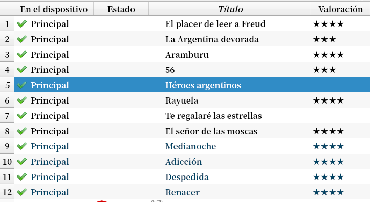

Plugin version 1.14.9
Calibre 5.10.1
Here I send you the txt files, two of which are My Clippings.txt from where I could get the notes and another My notes.txt where the notes from another book marked on the kindle are.
The kindle is with Spanish language.
And in the image the books that Calibre recognizes in the device.
Calibre 5.10.1
Looking at these files:
"My Clippings.txt"
That has annotations or one book titles "56" by "Jorge Lanata". In it, the start of each has "La" instead of either "Mi" or "Tu". You reported a problem a while ago and I added "La subrayado" for annotations, but, I did not know if the other two should be added. The attached beta has "La nota" for notes and "La marcador" for bookmarks. Your file doesn't have an example bookmark, but, it is a fairly safe guess.
A book with just a number for the title is fairly unusual. And it is a very short title. It is possible this is not being handled properly. Could you test another book?
"Mi notas.txt"
This has the same format as the "My Clippings.txt" file. Is this a copy you made or did the Kindle produced it for those annotations? I have had a report of a different name for Kindles set to German and the plugin looks or that. But, it is only processing one file, the first of 'My Clippings.txt' and 'Meine Clippings.txt' that is found. I can add "Mi notas.txt" to this, but, I need to know something about when it is used.
The debug log
Unfortunately, there isn't anything useful in it. It doesn't look like a device was connected or that the annotations were fetched. I need the debug log fro when the annotations are fetched to see what is happening.
The log does show a lot of other errors. It looks like you have a templates using columns "#estado" and "#gr10>2s" that do not exist. And a few plugins that probably haven't been updated for Python 3.

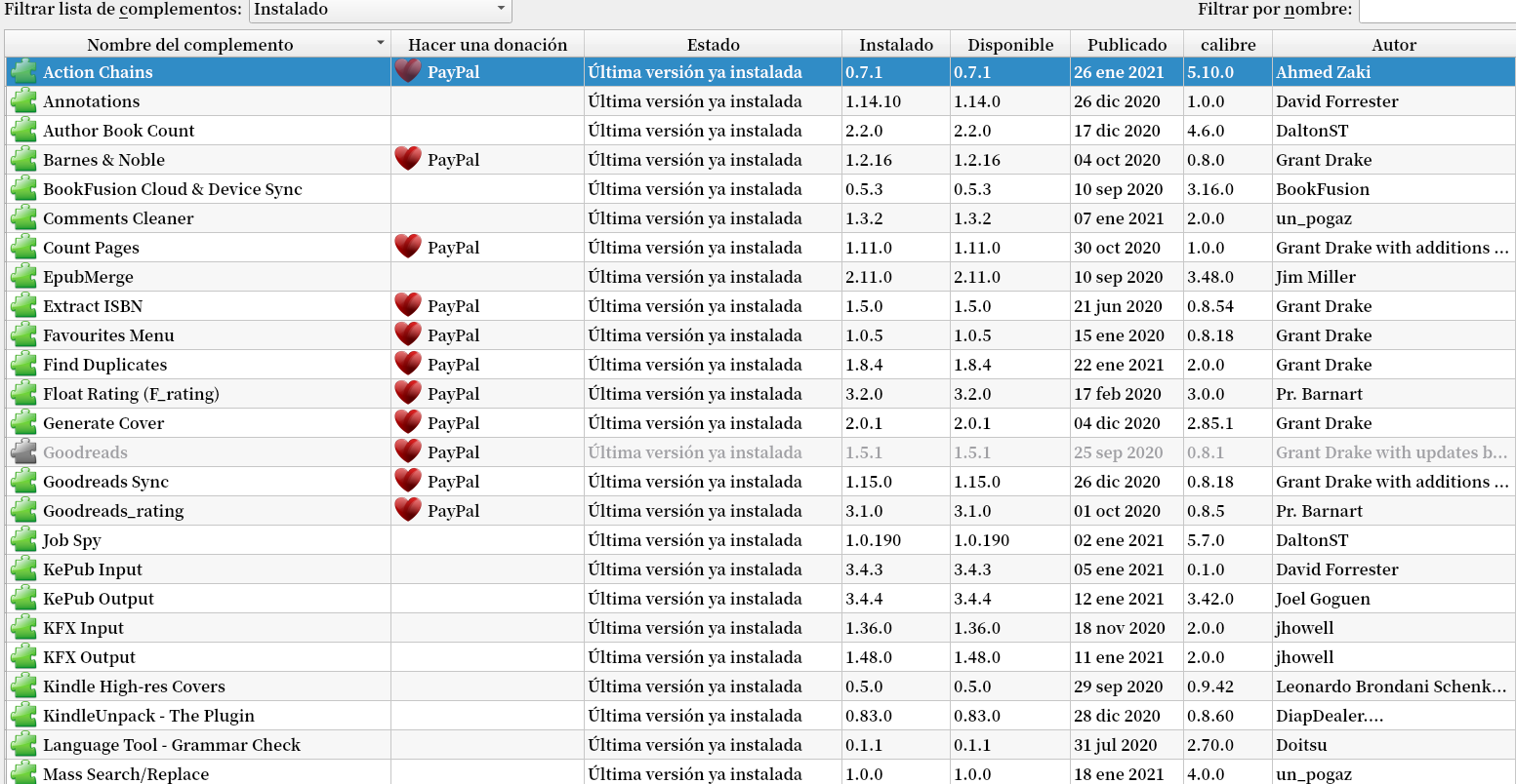

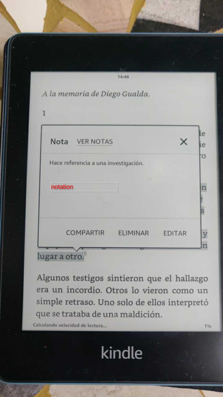

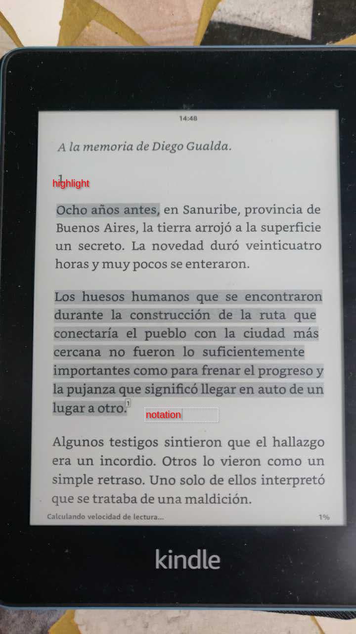

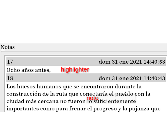

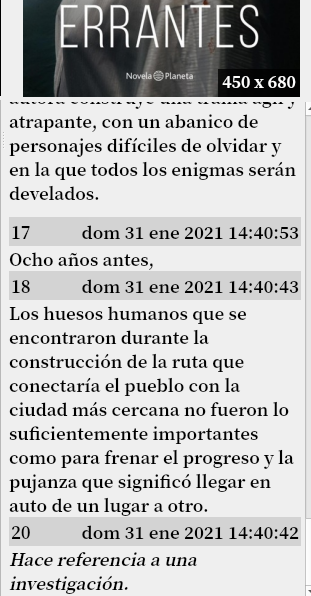

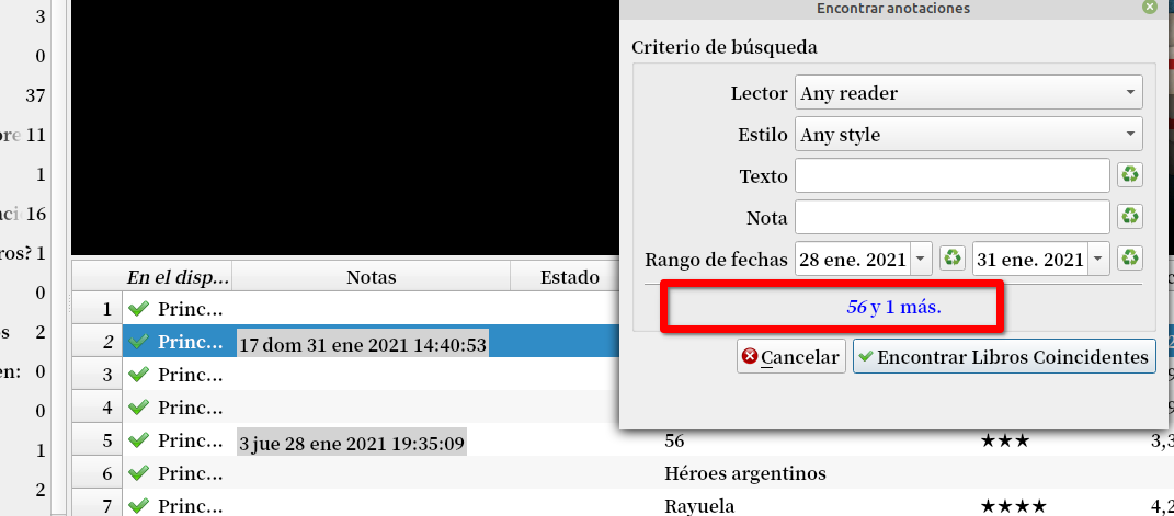

Apparently this latest beta solved the export problems, of the books added through the cable and through the mail, the marks and notes are added to the file My Clippings.txt.
My plugins are all updated to the latest version so I will check the errors that you tell me. Thank you very much for all your answers and I will see to complete the translation of the plugin into Spanish, which in my opinion is 50%.
I leave the debug file.

Not including it is a problem as contains information that is used when updating the annotation.
Do you mean you want something before each annotation if it is a "note" type? Or a text to indicate where the actual note starts to differentiate it from the highlighted text? Neither is possible at the moment and would need development (someway to configure it and then the code to handle it).
If it is the latter, the CSS is used to make the note and highlight part of the annotations different. I think I'd find extra words to be intrusive and not actually make things clearer. Exactly how to format it (bold, italics, size, same line? Hanging indent?) would also need to be thought about. And how much to make configurable. Or maybe a template that can be configured somewhere. I'm not sure of the best way, or if it is a good idea overall.
You can try putting "display:none;" in the CSS for this. I don't know if that will work or not.
Is a 'clean copy' mode a possibility? Where just the text content can be exported (clipboard or .txt or whatever) and not interfere with any of the location data.
I'm formatting the notes in another application, I suspect it's a pretty regular use case. Given that clipping.io is now a paid service, your is the only way to do this for free. So hopefully more users!
[Current workaround is to use a unique string in the 'Timestamp format' field, which allows you to Find All in a text editor and get rid of the location markers]
Any textual marker to mark the start of a note would help! Just like the 'Timestamp format' allows, since it would enable post processing through a text editor/macros.
To bring the formatting options inside the plugin does open up some questions, and would be a luxury if the above was possible.
The CSS gets stripped in a text editor is my problem, but I understand mine might be a fringe case.
