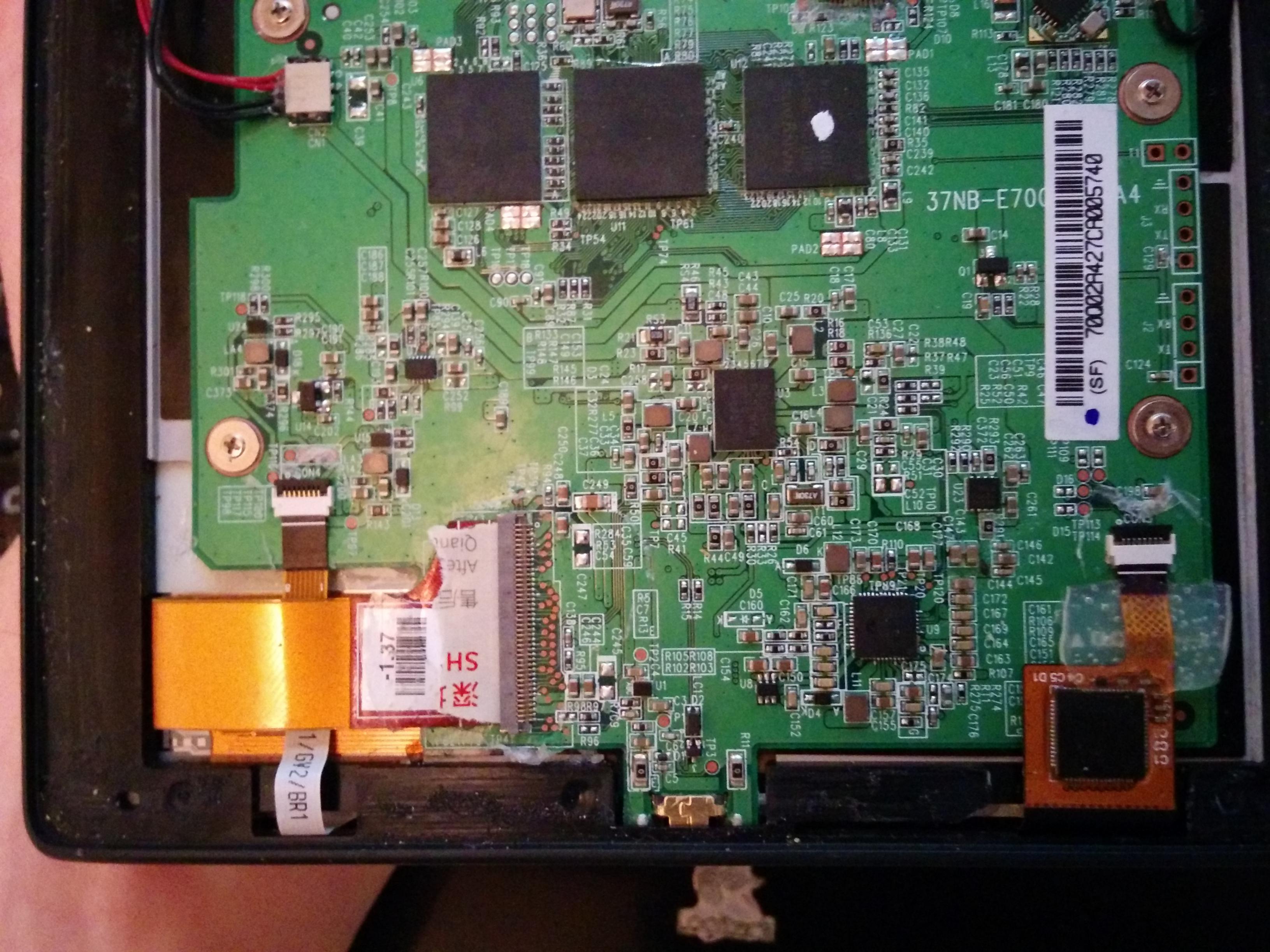

No screws holding the back on Aura One, its just glued. Just be careful on the bottom, there are two flex cables close to the edge that you could damage in the process(see attach). And when lifting the cover dont do it too fast, first peek at the touch controller(the chip with the flex cable on the bottom right), and see that its not glued to the cover(it can happen) and you dont rip it when pulling on the cover.
nice information, thank you very much. and how would you suggest cutting the glue, credit card?
Ideally plectrum, but credit card or something similar can be used as was suggested.
Most importantly dont use anything sharp, but you probably can at the sides just to get you started easier if you dont have a plectrum. And again be especially carefull at the bottom where those 2 flex cables are, and at the top where the battery is(similar clearance as the bottom).
On the sides theres plenty of clearance(10-15mm) as you can see on the pic, and very low chance on damaging anything. So id start with the sides and go towards top, and leave bottom last so you check for that touch controller isnt glued to the cover before lifting it.
