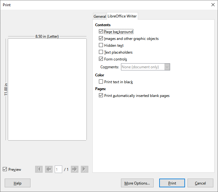

I once printed out of Notepad++, thinking it would appear as a basic text... it printed the entire black background + line numbers + everything else, with a few white words.
Horrible, and I'll never make that mistake again!
LibreOffice 7 has a few checkboxes:
The two key settings being "Page Background" and "Print text in black".
Old 01-26-2021, 01:12 AM   #7
