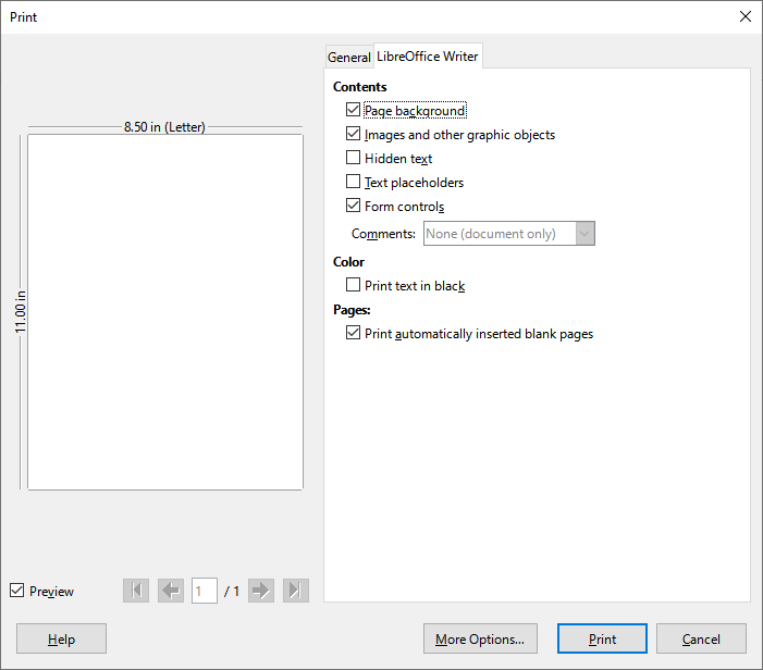

Tex2002ans 01-25-2021 10:40 PM
1 Attachment(s)
Originally Posted by DiapDealer (Post 4086266)
So while I have a working proof of concept, I'm probably going to put a few guardrails on this thing so people can choose whether or not they really, really, really want to empty their black ink cartridge when printing under certain conditions!
:thumbsup: I once printed out of Notepad++, thinking it would appear as a basic text... it printed the entire black background + line numbers + everything else, with a few white words.
Horrible, and I'll never make that mistake again!
LibreOffice 7 has a few checkboxes:
Attachment 184952
The two key settings being "Page Background" and "Print text in black".
