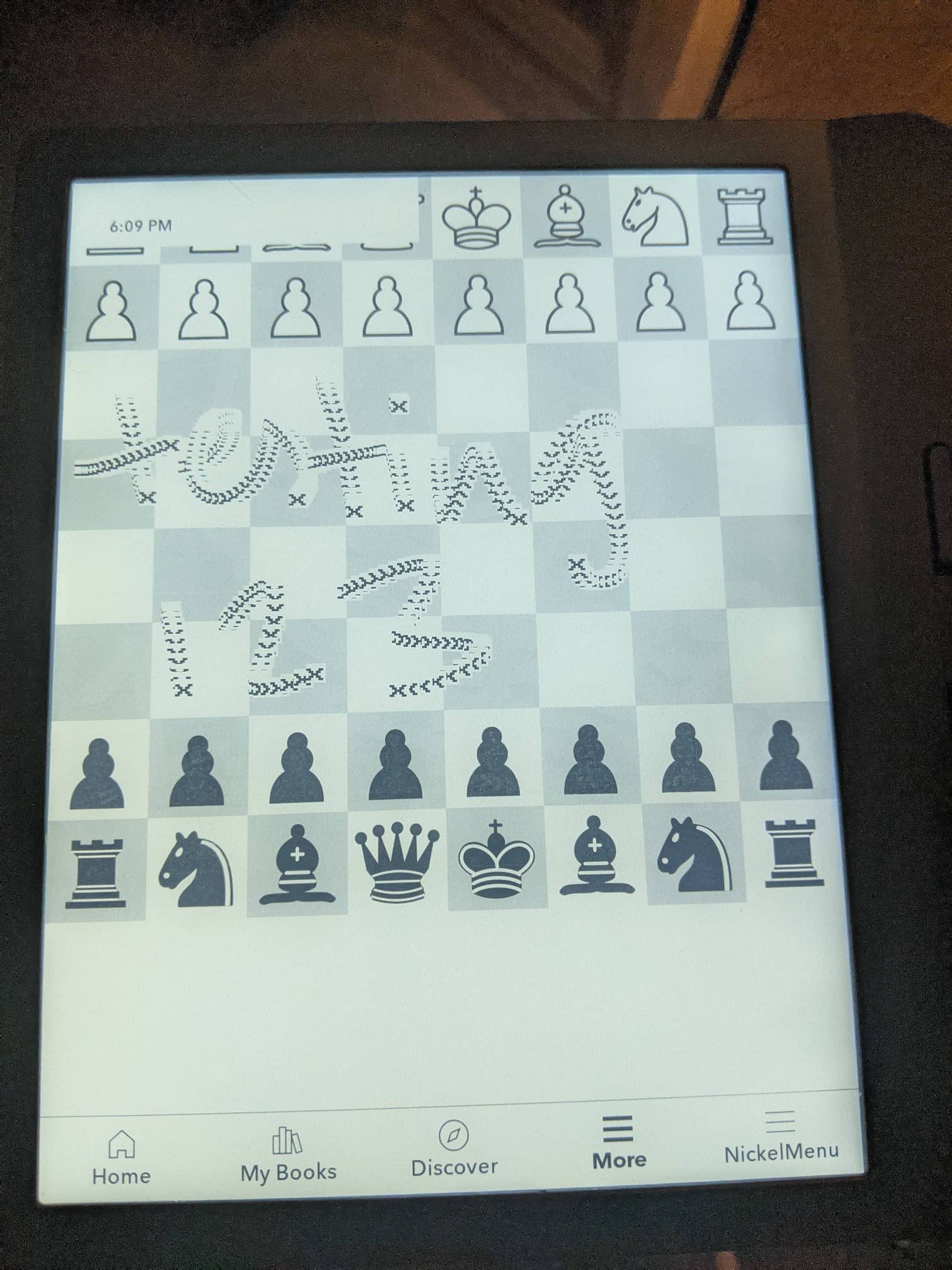

So, made some progress.. have a chessboard being drawn using calls to fbink_cls for the squares, and fbink_print_raw_data for the pieces extracted from a PNG sprite sheet using PIL.
Also have basic touch input working with libevdev. Didn't realise it even had the ability to "grab" the input built in! Sweet.
What's the deal when it comes to best practice drawing stuff to screen. I'm guessing that ideally you want to only draw stuff to screen that has changed to avoid unnecessary flickering, and that fbink doesn't do anything clever in this regard? Does fbink_cls do something special at a hardware level? Is it more efficient than printing an equivalent image for example?

The EPDC itself will do some amount of magic, but, generally, yeah, only repaint/refresh damaged areas.
That's only for *refreshes* though. Painting will always paint .
As far as FBInk is concerned, you can draw without refreshing the screen, which is useful when you have a bunch of small things to draw in a short amount of time that you only really care about displaying at once.
That usually involves setting the no_refresh flag in your FBInkConfig instance, and then doing a manual fbink_refresh call at the end of the batch, with the appropriate region to encompass all your new stuff.
