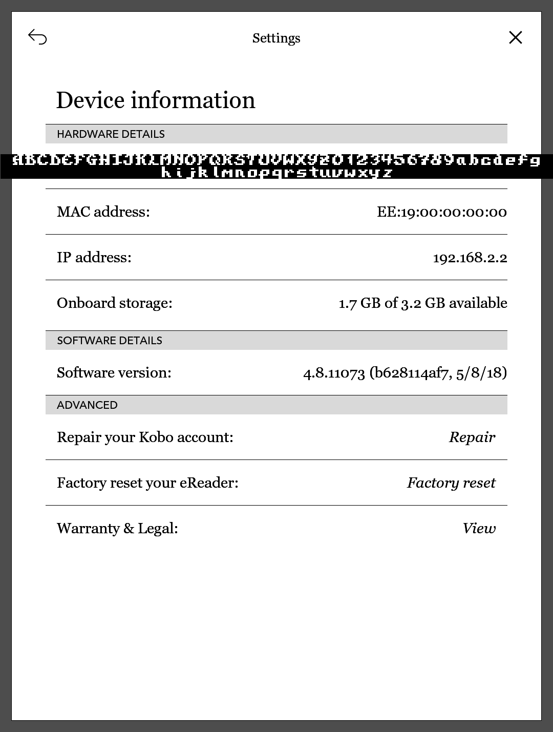

The lack of a small utility to print messages and images on screen (àla eips on Kindles) has been bugging me (and others, hi @frostschutz! ) for *quite* a while... So, I finally caved, and spent a few days working on this...
So here comes FBInk.
Basically, you feed it a string & a position on screen (row/column), and it'll print it there. Voilà.
There's a few helper flags if you want automagic padding, centering, or both, and it should break long strings over multiple-lines automatically (albeit in the dumbest fashion possible, no hyphenation, that's way out of scope here).
It has zero dependency besides the libc, since it's basically drawing monospaced monochrome glyphs straight to the framebuffer.
It's available as a standalone utility, which includes some of eips's more obscure features (like the ability to trigger specific mxcfb refresh calls without touching the fb at all), and as a C library, which is how I'm using it in KFMon.
Bindings are also available in Go, LuaJIT & Python .
Since v1.2.0, it can also display images, in the most common range of formats, with or without transparency .
Since v1.8.0, thanks to @sherman, it can also render OpenType/TrueType fonts .

@Python Master: I've got UTF-8 handled, so the next version should give you even more possibilities . (There's a few box drawing characters, since the font is basically IBM's venerable VGA font).
With a bit of tinkering, one *might* also be able to use Unscii, since it ships an 8x8 version in Unifont's hex format, which I *think* basically matches the C structures I'm using.
EDIT: Yes, it does, it just needs some massaging to format it as an actual C array, but the actual data is in the same format .
EDIT²: Okay, make that "almost" the same format. I'm rendering glyphs mirrored on the vertical axis at the end of my experiment... (Or mirrored on the horizontal axis with a bit of tweaking)... Or I can do a 90° angle with a code tweak... .

Because that was bugging me, got the situation under control.
It's not particularly pretty, I'm not sure it's correct, and there's a (minor) code change that makes it incompatible with the default font, but, FOR SCIENCE!
unscii-fantasy .
EDIT: And a few of the other unscii variants, because I'm having fun, and that's an excuse to road test the conversion script .
EDIT²: Got the conversion issue fixed. No need for code tweaks anymore :}.

There, pushed a new build (0.9.5-28).
This one handles UTF-8 input, correctly honors LF characters (NOT the escape sequence, the actual 0x0A character), and a few minor bugfixes (mainly around padding, and passing multiple long string to the commandline utility).
The LF thing is mainly aimed at being able to tail logs at it and having them flood your screen ;D.
