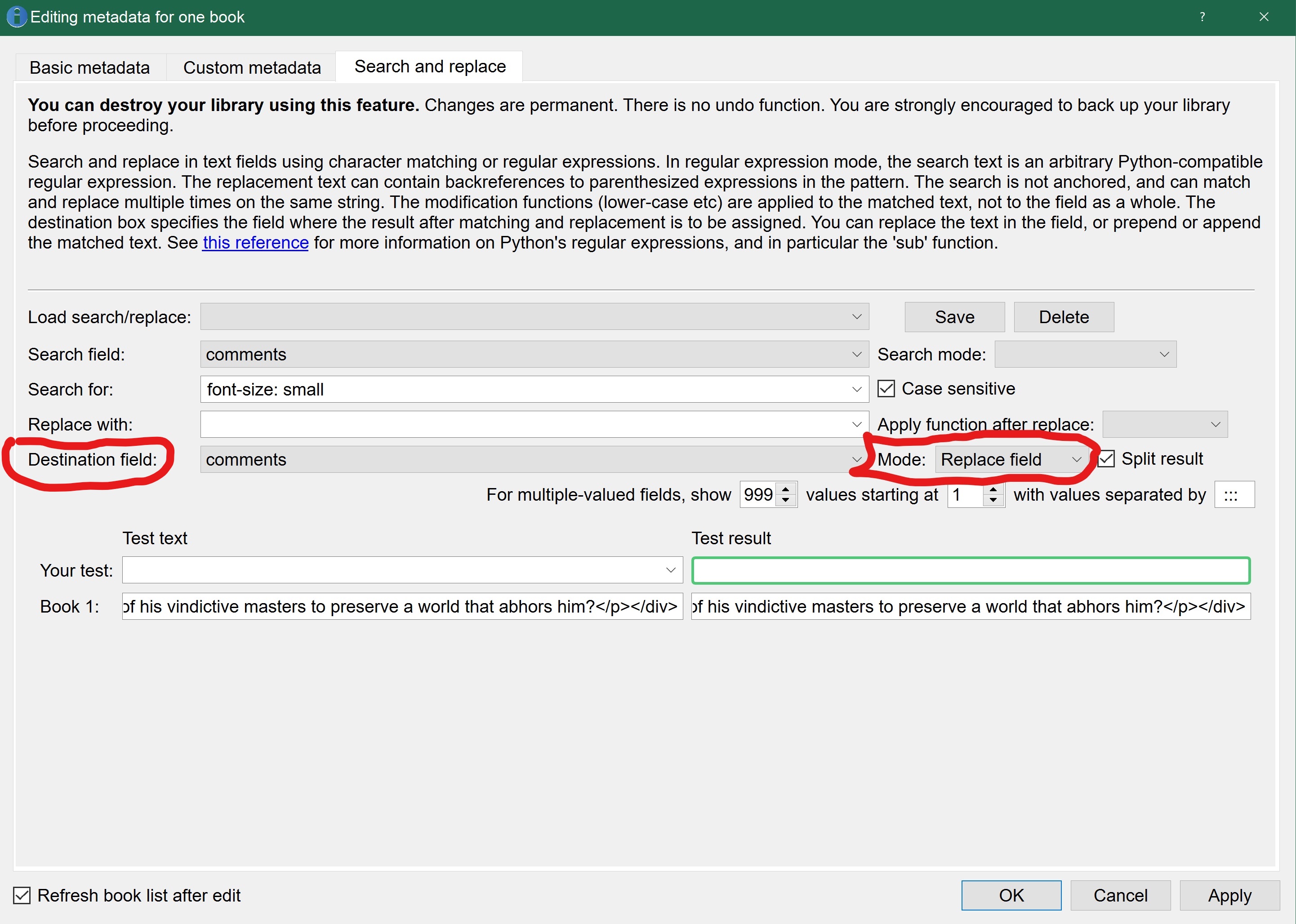

Select all books, right-click Edit Metadata -> Edit Metadata in Bulk -> Search and Replace. Search field: comments, search for: font-size: small, replace with: leave it blank, destination field: comments, mode: replace field.
This should do what you want.
Edit: try it with a couple of books first, just in case.

I've added a screenshot.

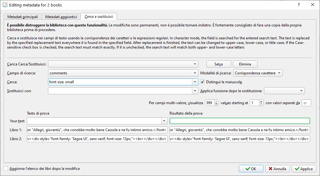

what Calibre?
Wow ... I was afraid of being dumb ...
I use the latest version (5.9 64bit) of Calibre but there are no fields indicated by you !!!
Maybe I need to install some particular app to make them appear or do you use another type of Calibre?

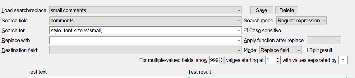

Modalita ? Regular expressions

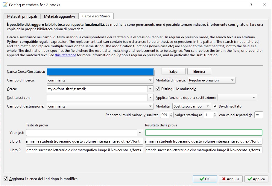

It works (I just tested this S&R ). The field IS comments. What you see is a VIEW

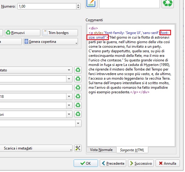

I'm really sorry for this problem….
it may be that the field "load search/replace" it is necessary, but on mine Calibre is not accessible, maybe I need to activate some function?
In any case thanks again for the help.

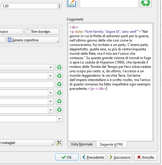

Your screen shot shows the end of the comment in the test text field. As it ends in "</font>", there should be a matching font tag with the attributes. You should be able to put the cursor in one of these fields and move through it to find the tag.
Try the search and replace that @Sirtel suggested on a couple of books and see what it does.
