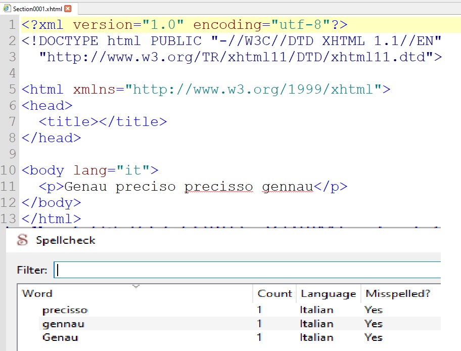

Still doesn't work. See attachment.
I'm getting the same results as you.
BTW, have you replaced your Italian dictionary with the one that I've attached to post #3?
With German as the primary dictionary and Italian as the secondary dictionary, I'm getting this:
With Italian as the primary dictionary and German as the secondary dictionary, I'm getting this:
@KevinH shouldn't the Spellcheck dialog box display "gennau" as a misspelled German word, if German is selected as the primary dictionary?

I'm checking the words from the spellcheck list, not from the book.
Yes, I tried that Italian dictionary and it's worse. It doesn't recognize some very common words, basic ones like "cioè". No idea why.
