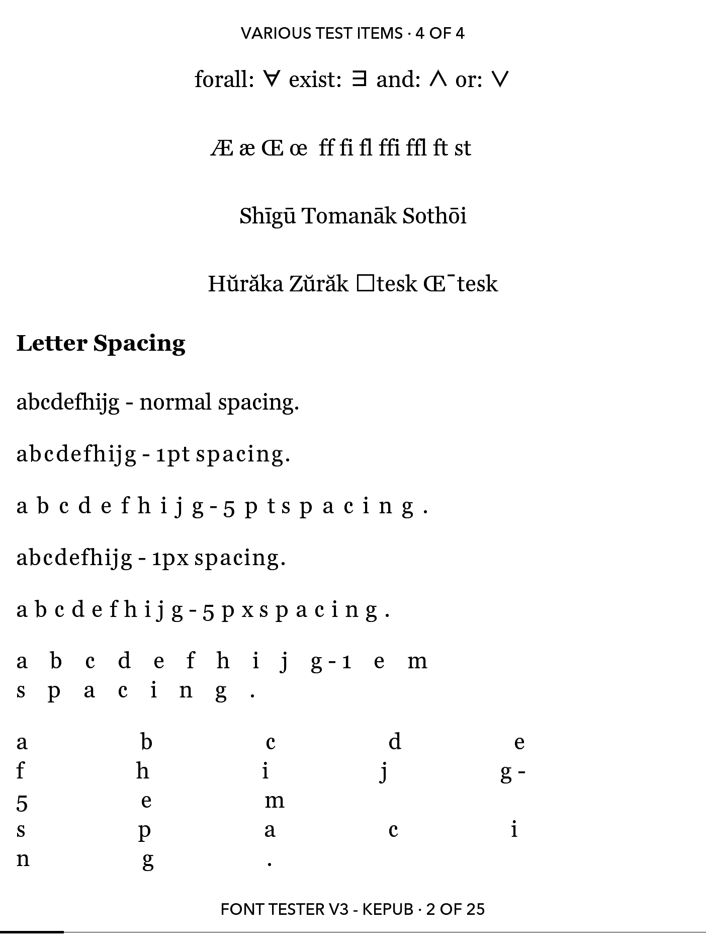

But, playing with it in one of the test books I have, I added the following:
  <h4><b>Letter Spacing</b></h4>
  <p>abcdefhijg - normal spacing.</p>
  <p class="letterspacing1pt">abcdefhijg - 1pt spacing.</p>
  <p class="letterspacing5pt">abcdefhijg - 5pt spacing.</p>
  <p class="letterspacing1px">abcdefhijg - 1px spacing.</p>
  <p class="letterspacing5px">abcdefhijg - 5px spacing.</p>
  <p class="letterspacing1em">abcdefhijg - 1em spacing.</p>
  <p class="letterspacing5em">abcdefhijg - 5em spacing.</p>
And in the stylesheet:
.letterspacing1pt {
  letter-spacing: 1pt;
.letterspacing5pt {
  letter-spacing: 5pt;
.letterspacing1px {
  letter-spacing: 1px;
.letterspacing5px {
  letter-spacing: 5px;
.letterspacing1em {
  letter-spacing: 1em;
.letterspacing5em {
  letter-spacing: 5em;
The in-word spacing seems to be OK, but, the space between the words appears to be the normal width of a space. Which makes it very hard to see where the word break is.
This was with the publisher font, and the size was just to make sure it all fit on one screen. And no patches.
And, yes, I do know that 5em is ridiculous, but, that was sort of the point.
Hmm, curious. Your screenshot suggests it's all working as it should, with all px, pt, em, doesn't it - at least with <p> tags?
Just to confuse matters - unless things have changed very recently - there seems to be a line in the kepub-book.css kepub override CSS in the fw.
body,p,div {letter-spacing: normal !important; }
I wonder what effect that's meant to have on a kepub using letter-spacing? It looks like it ought to forcibly ignore letter-spacing in <body>, <div>, <p> tags, but your tests suggest that's not the case.
Yes, my testing of kepubs suggest it is working. Except around spaces. And that makes it hard to see the separation between word.
I can see that line in the current libnickel.so. Or at least in the extract I created by running strings.exe against it. There is one thing different about it compared to the other styles. There appears to be a leading space on the line. I wouldn't expect that to have an affect, but, it is different.
