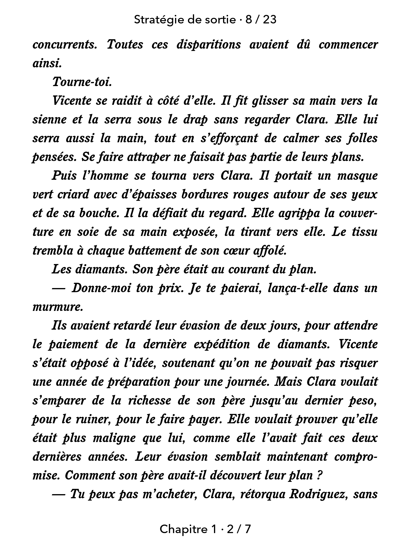

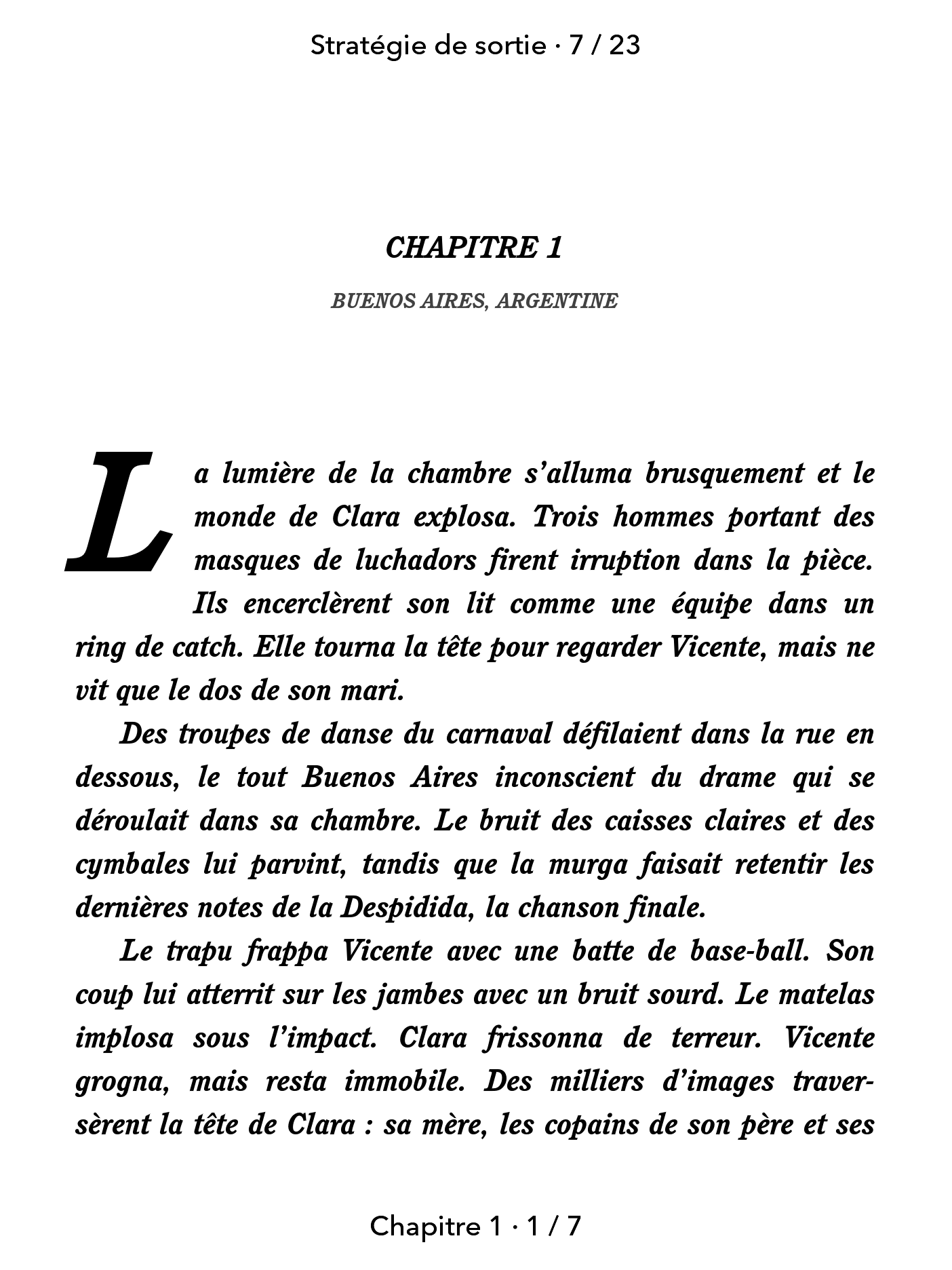

Old 08-20-2020, 01:20 AM   #563
danielk1591
danielk1591 began at the beginning.
Posts: 21
Join Date: Mar 2020
Location: France
Device: Pocketbook Inkpad X
You can't remove the message. That's why you see messages that read <message deleted> or similar.
Can you do a screenshot showing the issue. It makes it a lot easier if we can see what is going on. Add Screenshots=true under the [FeatureSettings] heading in the .kobo/Kobo/Kobo eReader.conf file. If you don't find [FeatureSettings], you'll need to add both lines. Use a Unix EOL aware editor (I use Notepad++ under Windows).
[FeatureSettings]
Screenshots=true
the difference may vary from book to book
ID:	181432   Click image for larger version
danielk1591 is offline   Reply With Quote

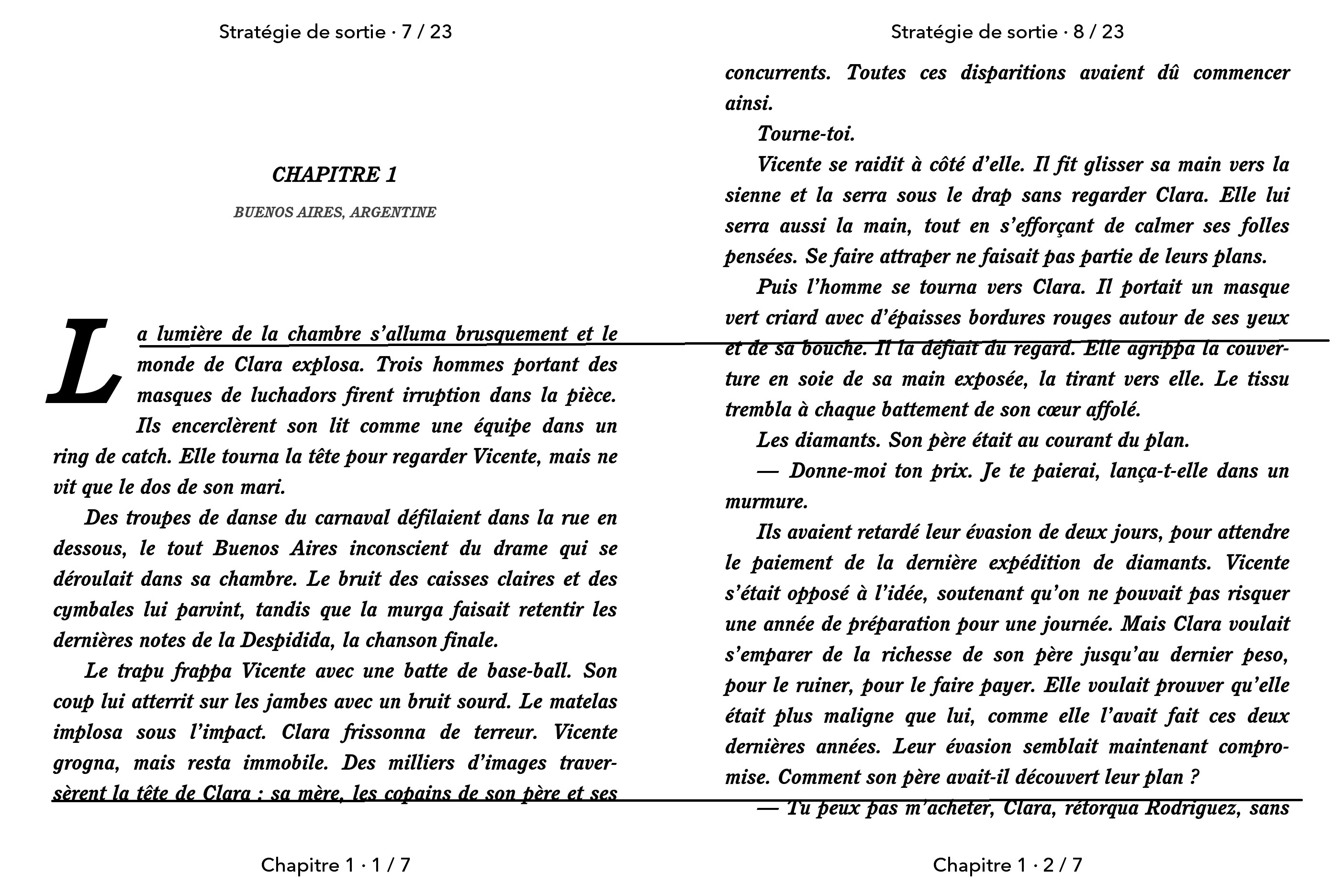

Old 08-20-2020, 12:57 PM   #568
Posts: 51,772
Karma: 180002898
Basically that the heading in the chapter moves the lines down the page and so there is not the space at the bottom of the first page to insert another line.
In pbooks, they would play with the spacing between the lines but ebook renderers aren't that smart.
See the attached image for a visual.
