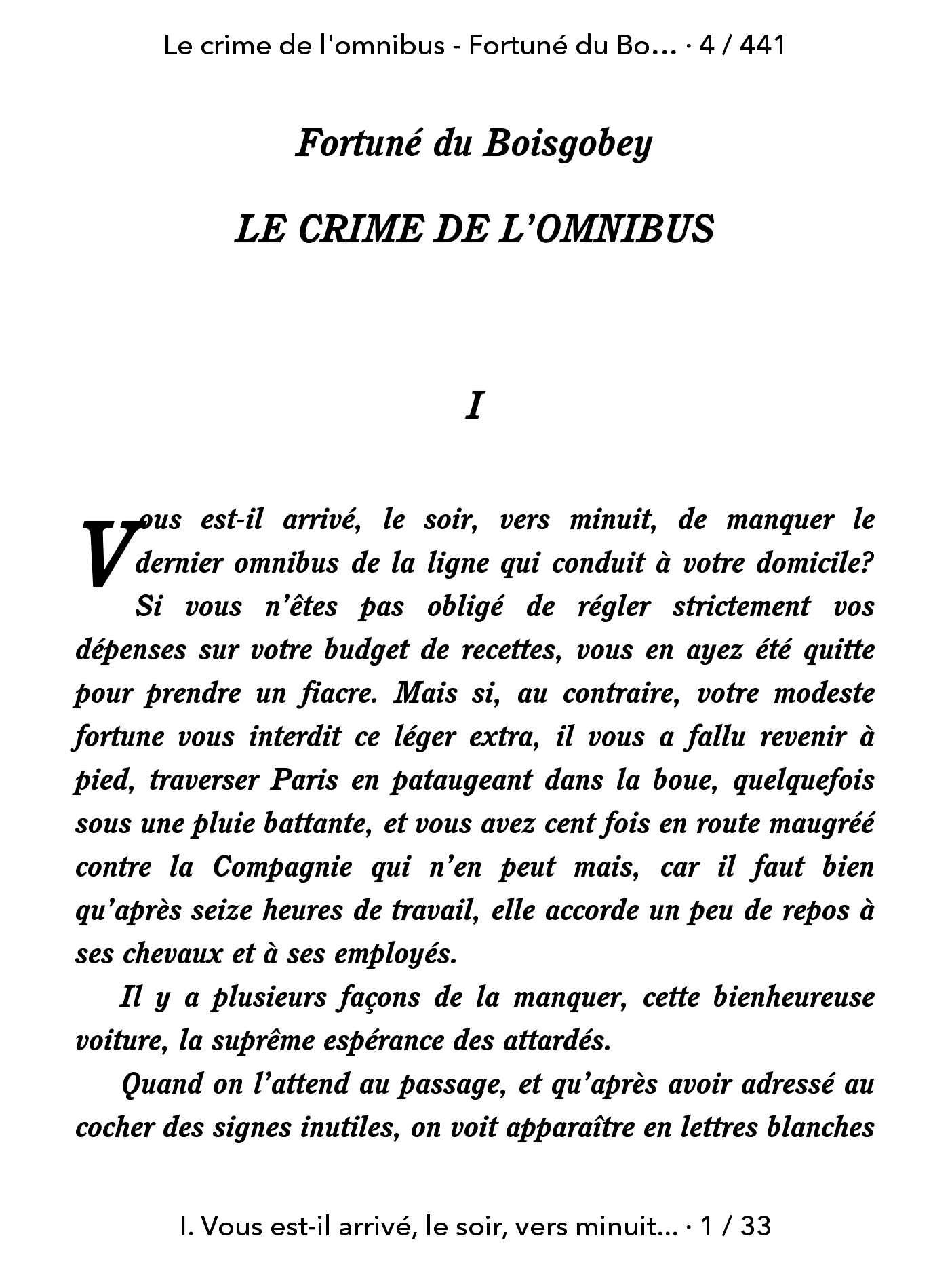

hello, the last line of the first page of the kepub paragraphs is not the same height as on the following pages. Is there a patch?
That could be something with the eBook. You could post the CSS code and the code for the first page. Or you can use the scramble eBook plugin and post the scrambled eBook.
When you do this, please start a new thread.

the problem appears on all epub and kepub that I read on my e-reader.
I import books with caliber.
Can you do a screenshot showing the issue. It makes it a lot easier if we can see what is going on. Add Screenshots=true under the [FeatureSettings] heading in the .kobo/Kobo/Kobo eReader.conf file. If you don't find [FeatureSettings], you'll need to add both lines. Use a Unix EOL aware editor (I use Notepad++ under Windows).

You can't remove the message. That's why you see messages that read <message deleted> or similar.
[FeatureSettings]
Screenshots=true
here and thank you for your help
