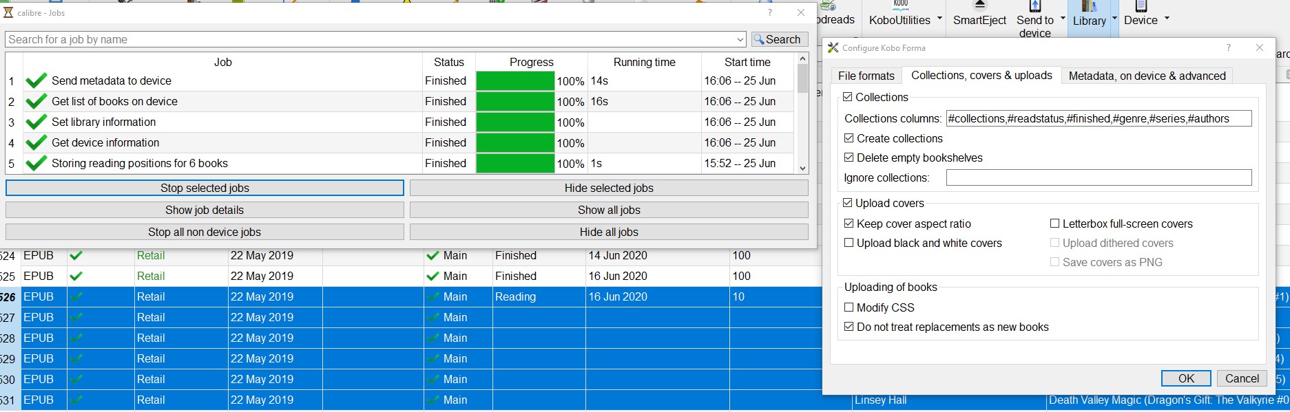

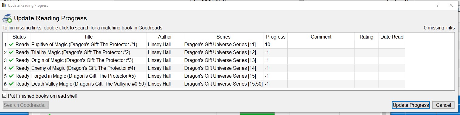

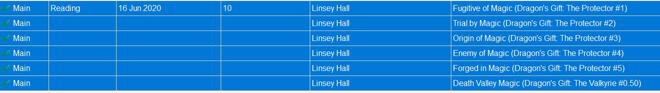

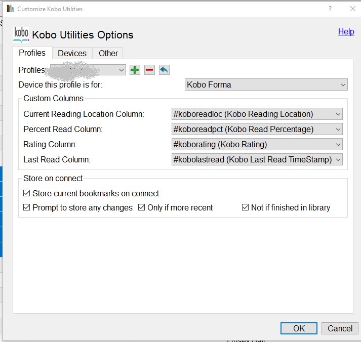

Trying to Figure out a problem with Storing and uploading reading positions within Calibre and Goodreads.
I never had a problem with my setup using my KA1 for several years. Both Kobo Utilities and Goodreads Sync but ever since it died and I bought the Kobo Forma I have been having issues.
All settings have remained the same with the exception of changing it to reflect the use of the Forma.
Problem: After finished reading books and starting new books, plug the Forma in and Calibre goes through the cycle of get list of books and updating metadata on device then when it would have normally automatically search for new reading status (finished/started) it does not.
If I manual try to "Store" the positions (highlighting the specific books in calibre) it goes through the process without errors but does not update the fields in calibre accordingly even though it shows the it shows the percentage read properly (fields remain empty) and then when proceeding to upload the currently reading and read status to Goodreads it shows a -1 under progress with no dates.
Last week I had been able to "manually" about to achieve a status update both in Calibre with Kobo Utilities and Goodreads Sync and Goodreads website of 10% read to currently reading but never automatically since receiving my Forma in March. But this week nothing works properly.
Any help would be much appreciated, I know this post would encompass 3 plugins and calibre but felt this would be the correct forum to post it in for further suggestions for help.
Thanks Crissman
Kobo Forma 32GB (4.22.15190)
Calibre Version: 4.19 (64 bit)
Kobo Utilities 2.11.0
Kobo Touch Extended: 3.2.12 (using the Kobo Touch Driver not the extended)
Goodreads Sync: 1.14.2
I have attached screenshots to reference everything for clarity.
Any help would be appreciated.

Looking at the first screen shot, the "Show reading positions changes" dialog, it shows the profile being used is "Chrysandra" and the device detected is "(Unknown device)".
The other screen to look at is the "Kobo Utilities Options" dialog. That shows an obscured profile name (which should be something other than "Chrysandra") that is for the device "Kobo Forma". If you look at the second tab, the device "Kobo Forma" will be listed.
In the settings, there will also be a profile called "Chrysandra". This is probably set to use "*Any device". And it will have a different set of custom columns than the "Chrysandra" profile.
The issue is that the plugin has lost the connection between the "Kobo Forma" device and the actual device. This usually happens a factory rest is done. There is identifier in the file "driveinfo.calibre" on the device. This is created by calibre the first time it sees the device, or whenever there isn't one. It has an identifier in it that calibre gets from the device and will change when a factory reset is done. It might change at other times, but, it would probably mean a reformat of the book partition. That means that if you setup device in the plugin, do a factory reset, calibre and the plugin will see the device as a new device. And if you look at the device list in the configuration dialog when it is connected, the "Status" column will not show an icon to indicate it is connected.
What is happening is that the plugin sees the device and works out which profile to use. Because it cannot identify the device, it is using the "Chrysandra" profile. This is getting the reading status, but, it isn't putting the progress into the custom column that the Goodreads Sync plugin uses. Hence the stats aren't showing properly.
The fix is to reidentify the device in the plugin and update the profile you are using to point to it. But, if you are only have one device, then I recommend just using one profile and having that use the "*Any device" option. You can probably delete the "Chrysandra" profile and change the one you have for the Kobo Forma.

Ok, that helped.
The obscured screenshot was also Chrysandra. Missed obscuring the first screenshot I had 4 devices and two profiles one for myself and one for my husband's kobo Libra H20. I had a total of 4 devices two each which were our 2 of our older devices.
I removed all profiles and all devices and re-added my forma with my "new" profile and all is well now.
Thanks Davidfor
