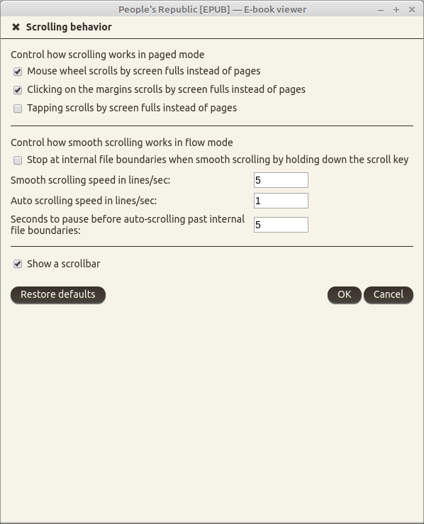

Please look at the screen shot, PAY attention to the part that says:
Stop At internal file boundaries when smooth scrolling by holding down the scroll key
Seconds to pause before auto-scrolling past internal file boundaries:
it sounds to me like you are in flow mode with auto scrolling enabled.
bernie
Name:	Screenshot from 2020-06-02 10-50-19.png
