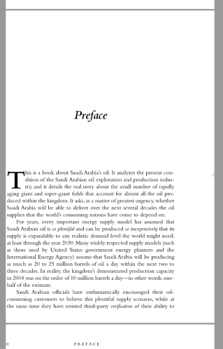

Hello,
I'd like to remove the margins from PDF pages so that each page fills the entire page, before turning them into PNG files, so that pages with complicated layout display fine on e-readers.
cpdf looks like it can do this, but I'm lost at which command to use: crop? mediabox? What settings to use?
Thank you.

I suspect the crop argument to cpdf would do it.

I can't figure out if cpdf can crop/trim margins. This just copies the input file as-is, with no change:
cpdf -page-info input.pdf 72-75
Page 72:
Label: 45
MediaBox: 0.000000 0.000000 534.000000 750.000000
CropBox: 43.200000 61.200000 472.800020 706.799990
BleedBox:
TrimBox: 42.000000 60.000000 474.000000 708.000000
ArtBox:
Rotation: 0
cpdf -crop "0mm 0mm 534mm 750mm" input.pdf -o out.pdf 72-75
I think you have a units mixup. 534mm is more than half a meter and 750mm is 3/4th meter.
The bare numbers are probably points (1/72nd inch).
Also 0 0 534 750 is no cropping. Try
cpdf -crop "100 100 400 600" nput.pdf -o out.pdf
That should be a severe crop.
If you really want mm and bare units is actually points, you need to multiply by 25.4/72

cpdf -crop "100 100 400 600" nput.pdf -o out.pdf5.4/72
Much better. Thanks for the infos about points.
I'll experiment and see how to remove the margins on all four sides, and maximize text.
