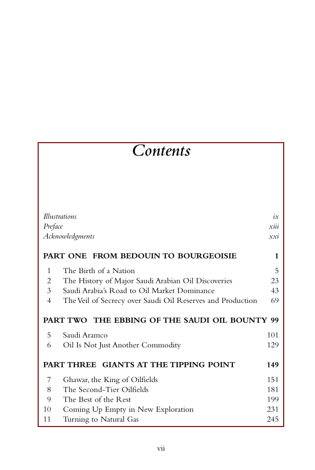

Hello,
I'd like to remove the margins from PDF pages so that each page fills the entire page, before turning them into PNG files, so that pages with complicated layout display fine on e-readers.
cpdf looks like it can do this, but I'm lost at which command to use: crop? mediabox? What settings to use?
Thank you.

cpdf -crop "0mm 0mm 534mm 750mm" input.pdf -o out.pdf 72-75

cpdf -crop "100 100 400 600" nput.pdf -o out.pdf5.4/72
Much better. Thanks for the infos about points.
I'll experiment and see how to remove the margins on all four sides, and maximize text.
