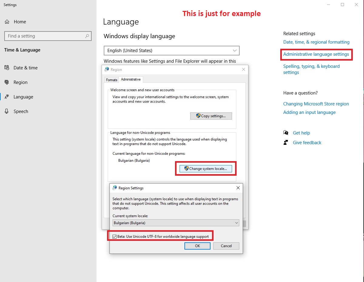

I solved а problem I had with Kobo Touch Extended 3.2.2 add-on.
I've included the "Beta: Use Unicode UTF-8 for wordwide language support" option in "Language for non-Unicode programs" and everything works now.
First, I tried to choose English in "Regional settings" in "Non-Unicode programs", but that didn't work.
In general, if the Windows Display language is EN, there seems to be no problem.
However, I wonder why the problem occurred with the new version, while with version 3.1.5 there were no problems.
Thanks to all of you who engaged in my problem. I also hope my decision would help those of you who are dealing with the same issue.
