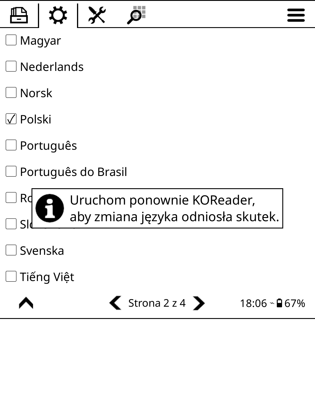

I have a Libra with 4.20.14622 software
I've been using Koreader for a long time and I've never had such a problem: I structured Koreader to version 2020.03.2 and it turned out that you can't set my language (Polish) in the menu, you can't set a language other than English.
Of course I restarted Koreader, I even restarted the ereader and it still changed nothing
Anyone have a similar problem?
Edemen is offline   Reply With Quote
Old 04-15-2020, 01:07 PM   #290
NiLuJe
BLAM!
NiLuJe's Avatar
Posts: 13,506
Karma: 26047202
Location: Paris, France
@Edemen: Details, please, because this obviously works for me.

I don't know what details to give I see it works for you.
Maybe something went wrong with the installation?

What do you actually see in the Language menu, what happens when you tap on your language, what exactly did you mean by "can't set a language", that sort of thing (i.e., details).

,,Please restart KOReader for the new language setting to take effect."
Strange that not in Polish but in English, right?

And what happens after a KOReader restart? Everything still in English? Which language is checked in the Language menu?

After restarting, Polish is selected, but the menu is still in English.

@Edemen: Then, yeah, your installation is borked. I double-checked the tarball, the translation catalog is fine in there.
I'd reboot the Kobo, do a filesystems check, then reinstall KOReader.

As I thought
Thank you NiLuJe, I will install the koreader again.
