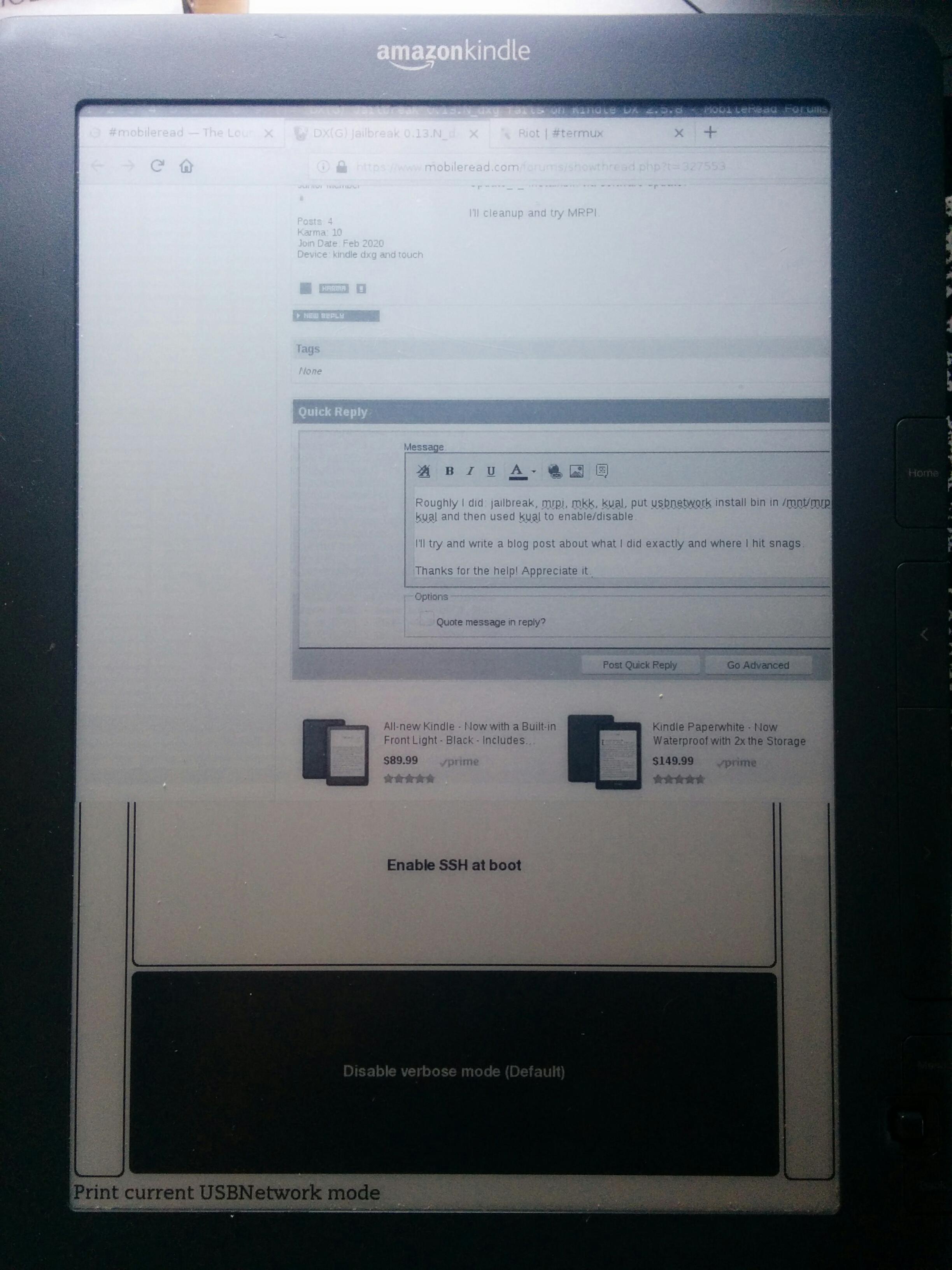

Ok. All works great now. I have my local X11 session on debian with x11vnc going to my kindle. Just need to cleanup setup and config and I'll have my nice e-monitor.
Roughly I did: jailbreak, mrpi, mkk, kual, put usbnetwork install bin in /mnt/mrpackages, installed via kual and then used kual to enable/disable.
I'll try and write a blog post about what I did exactly and where I hit snags.
Thanks for the help! Appreciate it.
