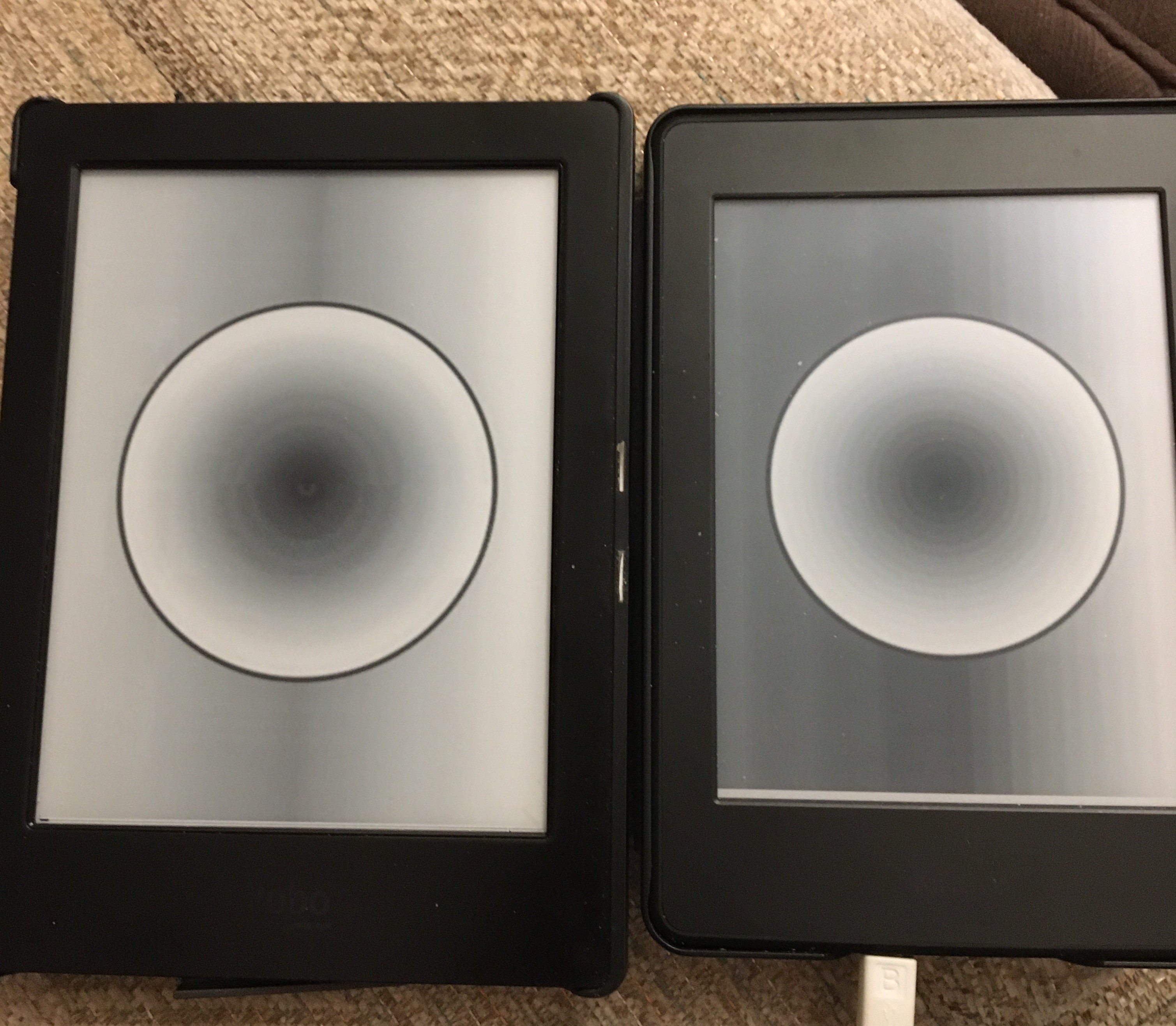

Old 02-04-2020, 06:39 PM   #59
Posts: 80,719
Karma: 150249619
I figured out the easiest way to do it. I made the image a cover for the PW3.
OK, here is NiLuJe's Trouble PNG in color on my Aura H2O (1st ed.) and on a PW3. The image on the left is the H2O and on the right is the PW3.
You can see that the H2O has dithered the image better then the PW3.

Old 02-04-2020, 07:41 PM   #60
NiLuJe
BLAM!
NiLuJe's Avatar
Posts: 13,506
Karma: 26047202
Location: Paris, France
... because Nickel always dithers image content on its own (inline, cover, sleep, roughly all the things that matter in current FW revisions. Speaking of the KePub renderer, because I won't touch ePubs with a ten-foot pole on Kobo), which we already knew ^^.
*How* it actually does that depends heavily on the specific device, though (and on the FW version. It used to be worse. Which, ironically, was slightly better if your content was pre-processed properly ^^).
(On the H2O, it's easy: there's no hardware/kernel support for it, so it's all Nickel).
