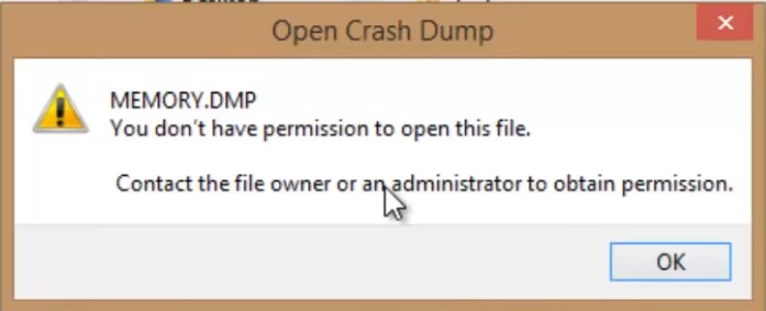

‘You don’t have permission to open this file' is a long standing Windows msg.
Name:	Annotation 2020-01-25 143721.jpg

Actually, I'm seeing this in the changelog for the next release of Sigil:
"- Fix bug in Insert Files from Disk"
Wondering if it's related. I'll see if I track down the bug discussion.
