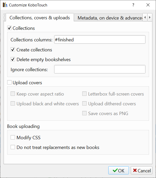

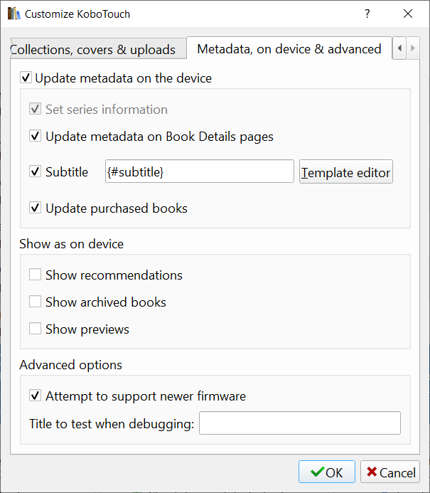

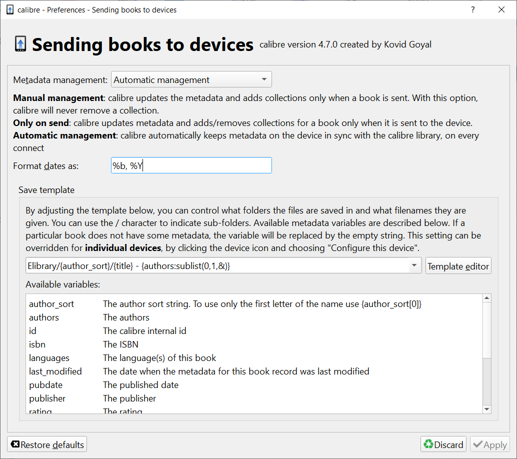

You should not need to transfer the same books again. If you do not have the "Do not treat replacements as new books" option checked, it will not work (see the first KoboTouch configuration page image attached). You will need the two connections since the first sends the books which will be imported when you eject your Kobo. The import process creates the database entry for the ebook which is needed to add the series, etc. information.
What I have is the Automatic Metadata management turned on in Preferences => Send to device and other options set in the KoboTouch driver configuration. I've attached images of what I use. Don't use the subtitle stuff unless you have calibre set up for subtitles.
ID:	175928   Click image for larger version
ID:	175929   Click image for larger version

In Calibre preferences, do you have Metadata Management set to Automatic management? It's in the Import/export section under Sending books to device.
You should not have to manually update the metadata when you plug in your Kobo after the newly added books have been processed.
Which Kobo driver are you using? Are you using the KoboTouch driver or the KoboTouchExtended driver? Check in plugins to see which one. If it is the Extended driver, customize it and check the Metadata tab and make sure Update metadata on the device us checked. You also want Set series information and Update Metadata on book details page checked.
Please report back if you have solved your problem. And yes, you still have to plug the Kobo in a second time.
