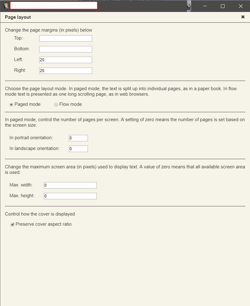

I figured out how to stop the search bar hiding text and how to make the Percent Read not come and go - set top and bottom margins to non zero. The default settings for the margins in the beta is zero, maybe they should be changed to ??.
If I search for something and its not found I get an intrusive pop up message that can only be dismissed by using a mouse left click on its black X - after which I can't move the text with the keyboard until I move it with the mouse scroll wheel Ψ³
The default settings are definitely not zero
This is from a portable 3.99.8 installed a few minutes ago

This is from a portable 3.99.8 installed on Friday (late) that I altered this afternoon
Name:	Annotation 2019-09-29 205500.jpg

@BR: The default top/bottom margins are 20 however there was a bug in the viewer settings migration code where if there were no previous viewer settings, the top and bottom margins were being set to zero. Now fixed.
Eh - when I installed version 3.99. 32bit I was disappointed that none of my existing viewer settings (e.g. colors) were 'migrated' - I sighed, shrugged, and moved on. If they should have been migrated, then one reason I can think of why they might not have been, is that my configuration is not in the default location; it is in the location referenced by CALIBRE_CONFIG_DIRECTORY.
You might recall I had a loss of window size issue when switching between 3.47 and 3.99 - see post #18. Given the fact that my settings were not migrated, and I had the Qt induced window size problem, I uninstalled the 32bit version and installed a fresh portable.
But all that's largely irrelevant, but the loss of keyboard functionality after using search is very relevant. It's just the Search Tool that does that - and maybe the Error popup. Using the ToC or Lookup tools does not lead to loss of keyboard functionality.
