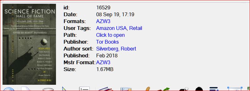

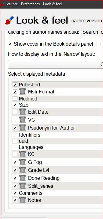

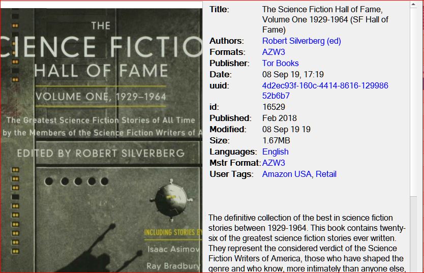

You are right, the viewer is different. I am not sure if I like the spinning gear between sections (next file loading). Can that be suppressed?
Details (comments) are missing when I click for the details (brown book on the status bar). They ARE there if I use the Info tool.

The spinning gear is there in the current viewer as well (it's not a gear but a spinning wheel in an overlay) but otherwise is the same. Something has to show up between file loads.
Comments are not showing up in the book details panel?

T
That is correct. Only the other metadata fields (thos that were on the left edge of that pane.
They are there in the Edit panel
They are there in the I(nfo) box

Strange, are comments enabled in Preferences->Look & feel->Book details?

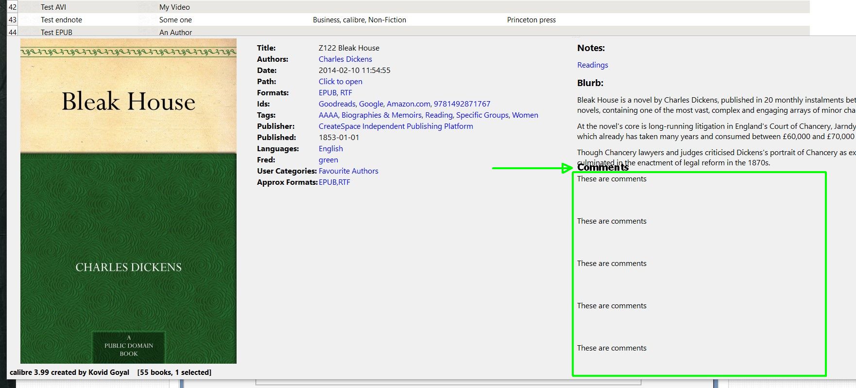

I have horizontal book details, and I can see the built in Comments and my custom long text column Notes.
Would it be possible to put the word Comments above the Comments - the words Notes and Blurb you see below are my custom column Column header values

Have you fixed this already!!
Attachment 173323
You are most correct.
After I made the pane huge (I have always had it like the Image).
They simply were underneath, not alongside as they were before.

@BR and @theducks The comments not appearing side-by-side happens only if you have the setting to have them float in Preferences->Look & feel->book display -- because the Qt widget does not support floating. I have fixed it by removing that setting, now it will always display in fixed columns. https://github.com/kovidgoyal/calibr...d6f3abeaa4fa37
@BR: The comments title not appearing has nothing to do with this beta, you can open a ticket for it after the beta process.
