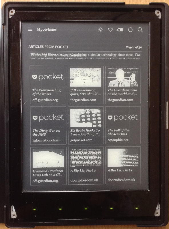

Hi there, my Kobo aura H2O froze up when 'returning to articles' from a Pocket article. The screen was in mid refresh and is now mostly in inverse video. The touch screen is no longer responsive. Sleep or power down does turn off the backlight, but does not update the screen. Wake-up/power on brings the backlight back on, but nothing else. The LED in the switch comes on constantly initially, but then starts flashing.
It seems it is a least trying to boot but then giving up part way through.
The pinhole reset does the same thing.
The Kobo does take a charge too nor has it been dropped or dunked, so I'm thinking this is not a hardware fault.
Looking at similar threads it appears it may be a failing SD card.
I have no back up, so I hope not.
I thought I might try disconnecting the battery and reconnecting it might jump start the whole machine, but after that I'm out of ideas.
Either way, it looks like I'll have to crack the thing open. It will lose it's waterproofing but I don't read in the shower anyways.
If anybody has any other suggestions or things I might try, they would be welcome.

Are you sure you don't have a broken substrate? Post a pic and it usually obvious to those who've seen broken substrates before. Other thing that can sometimes be diagnosed with a pic would be a controller failure. Those are the 2 most common issues for non-changing screens.
The substrate is to all appearances intact, no cracks, no messed up/striped areas etc. It was in mid-refresh, so there is a part of the previous screen still showing and it is in inverse video, but that is just when it happened to fail, not because of physical damage.
Can you please post a photo? Thanks
Sadly, no - I don't have a camera at the moment.
I have seen other photos of broken substrate here and my screen doesn't look like them, plus it froze up whilst I was using it - it was working just fine until then.
DomesticExtremis is offline   Reply With Quote

OK so I looked again with very bright light and high magnification and can see no obvious cracks in the screen. I took the motherboard out from the back and can see the edge of the screen rear. Along the long edges there are two lines on a shallow diagonal - they looked like cracks, but I think the may be embedded conductor paths because there are tow of them and they are too straight to be glass cracks - I would expect those to be curved.
I finally borrowed a camera, just an iPad , to get an image of the screen attached.
