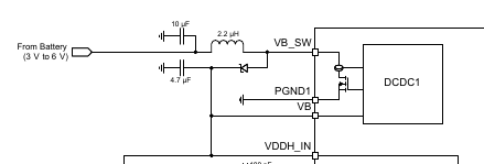

So the task is to figure out what is causing this error and preventing the boting of my ereader.
It is plausible that a broken and shorted substrate could pull down a voltage somewhere and cause the error seen, so we cannot eliminate that fully yet. However, it is far more likely that either the chip itself is faulty or that some support component or power supply circuitry for it is faulty.
The chip is from Texas Instruments and is well documented (http://www.ti.com/product/TPS65185/technicaldocuments).
There is a data sheet (http://www.ti.com/lit/gpn/tps65185) and a guide on understanding undervoltage conditions (http://www.ti.com/lit/pdf/slva769), which might give me some clues as to how to proceed. In addition, they seem readily available on Ebay for just a few kopecs.
I should add that I am no electronics engineer and will take a while to understand these documents. Anybody who knows more than me or has any tips and tricks on how to proceed is welcome to chip in.
The PMIC seems fine (it is already initialized in u-boot) and all it does is fault handling using a https://en.wikipedia.org/wiki/Undervoltage-lockout threshold.
If you have the equipment you can measure PMIC Vin and see if it is above minimum (3.0v).

Good news - the datasheet is fantastically detailed (and in many places utter gobbledegook to me )
DCDC1 is an internal switching boost converter which only affects 3 or 4 pins and relies on a relatively small amount of external components.
See the attached section of the block diagram (pictures,yay!).
Moreover, there is quite a clever power up/power down sequence. Correct functioning of DCDC1 is tested early on so if not regulating properly the chip will stop the power up sequence and shutdown nicely - thus protecting the other circuitry.
So either the internal MOSFET is burned, one of the support components for the boost converter has failed or there is insufficient voltage on the supply, I think .

I'm not sure we have UVLO - that would mean insufficient input voltage to the ehtire chip. This has to be measured good prior to attempting the start up of the DCDC1 module. Power up of DCDC1 is the bit that is failing.
That is not to say that the screen is not borked or cracked (I can't see any crack and it failed in mid refresh), but the boot messages suggest something to do with the chip (possibly mistakenly, it's a dumb computer after all). I'm 90% sure the screen is good at the moment.
The data sheet says this (and much more):
8.3 Feature Description
8.3.1 Wake-Up and Power-Up Sequencing
The power-up and power-down order and timing is defined by user register settings. The default settings support the E Ink Vizplex panel and typically do not need to be changed.
In SLEEP mode the TPS65185x is completely turned off, the I 2 C registers are reset, and the device does not accept any I 2 C transaction. Pull the WAKEUP pin high with the PWRUP pin low and the device enters STANDBY mode which enables the I 2 C interface. Write to the UPSEQ0 register to define the order in which the output rails are enabled at power-up and to the UPSEQ1 registers to define the power-up delays between rails. Finally, set the ACTIVE bit in the ENABLE register to 1 to execute the power-up sequence and bring up all power rails.
Alternatively pull the PWRUP pin high (rising edge).
After the ACTIVE bit has been set, the negative boost converter (VN) is powered up first, followed by the positive boost (VB). The positive boost enable is gated by the internal power-good signal of the negative boost. Once VB is in regulation, it issues an internal power-good signal and after delay time UDLY1 has expired, STROBE1 is
issued. The rail assigned to STROBE1 will power up next and after its power-good signal has been asserted and delay time UDLY2 has expired, STROBE2 is issued. The sequence continues until STROBE4 has occurred and the last rail has been enabled.
So VB (our DCDC1 circuit) is powered up second after VN (DCDC2, should be -16V). I could try seeing if VN comes on and has the correct voltages, if they are wrong that might indicate a problem with the screen....
