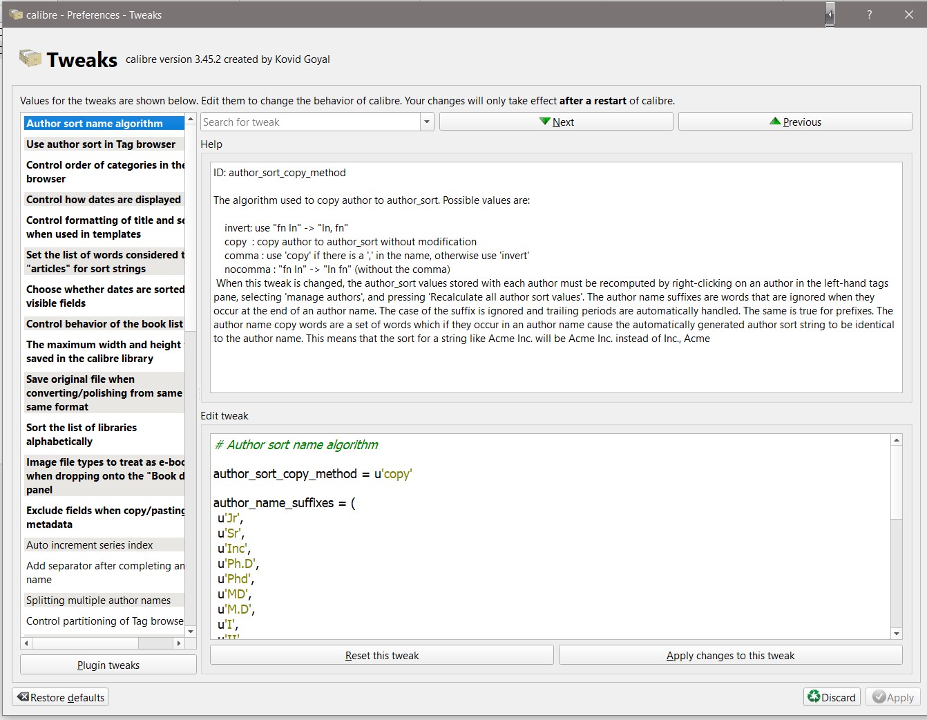

Is this intentional: strings in Tweak values must now be prefixed with a 'u', viz:
Name:	Annotation 2019-07-18 083542.jpg
Seems a bit arcane, maybe it's been like that for a while and I hadn't noticed.
Old 07-17-2019, 09:39 PM   #23
Posts: 46,599
Karma: 29634066
It's a temporary thing, once calibre moves to python 3 the u prefix will be gone again. And you dont have to enter the u it will work without it as well.
