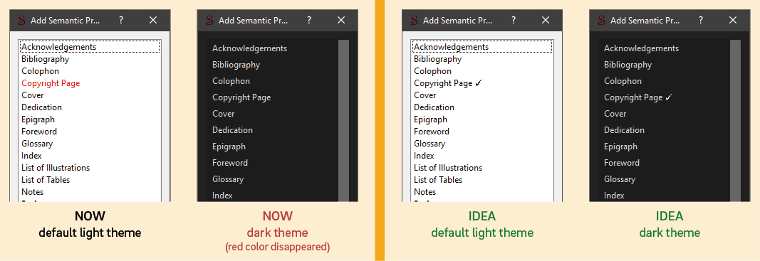

One note:
The red color is probably not visible with the dark theme, because you can not add style only for current semantic element. It would be worth building a version and checking on a dark theme in Mojave.
Using the QSS style – the red color disappears.
The solution would be simply to add a checkmark suggested by BetterRed here.
QString added_checkmark = name + " ✓";
item->setText(added_checkmark);

No the name itself is used in a dictionary lookup, so modifying the name itself is out.
I'm sorry, I do not know. It works for me.
Screen shots were real.
Why can't red be seen on a Dark motif? It is a foreground colour and not a background colour for the text. Red should show up on a dark or light background. That is why I chose it.
Yes, for REAL dark theme (like as Mojave).
But for QSS style if the current semantics does not have any css / qss class or id that can be individually configured - it looks like this: dark background and black text. The red color among black foreground on a dark background looks unattractive.
If I write style:
QListView::item {
  color: #d8d8d8;
...this style will overwrite the red color.
That's what I meant when I suggested a checkmark that always works.

The name string itself is used in a dictionary lookup. If you append a check char to the end, looking up the name will fail, which means you will not be able to toggle the previously set semantic in one step.
You're right. name + checkmark does not allow to deselect already assigned semantics.
It's always going to be possible for a user's custom qss and Sigil defaults to be at odds with each other. And "unattractive" is always going to be in the eye of the beholder.
BTW, any user could set their own qss and make any Sigil dialog pretty unusable.
You are right. But in this case the point is that creating the correct qss style in which this red color will be visible is IMHO impossible.
People wanted to be able to SEE if a semantic is already applied to a file in the semantics dialog. This accomplishes that without adding extra columns to an already crowded dialog.
I really appreciate this solution, because it significantly facilitates the work on e-books. I am sure that all users will welcome this feature.
I can handle it.

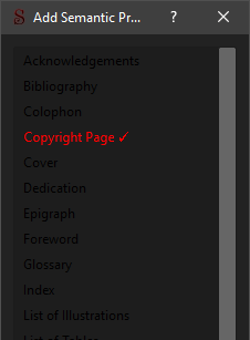

I could either set the foreground and background colour independent of theme, or use a text decoration like an underline. Would an underline be better than a vibrant red colour? I find underlines are harder to detect than a foreground colour like red.

Another possibility is to add checked versions of the names to the dictionary as well. Or even just the current name with check to the dictionary... that would work.

Yes this sounds like a good idea.
It will take some study and work.
So until then I have just pushed the space checkmark idea where we load the checked version of the name into the dictionary to prevent issues.
That should keep everyone happy for the upcoming release until we figure out how to do our own themes or at least figure out how to make theme-appropriate choices.

Double thank you for your understanding of users who use their own themes.
I confirm that it works great now (build on Win10).
