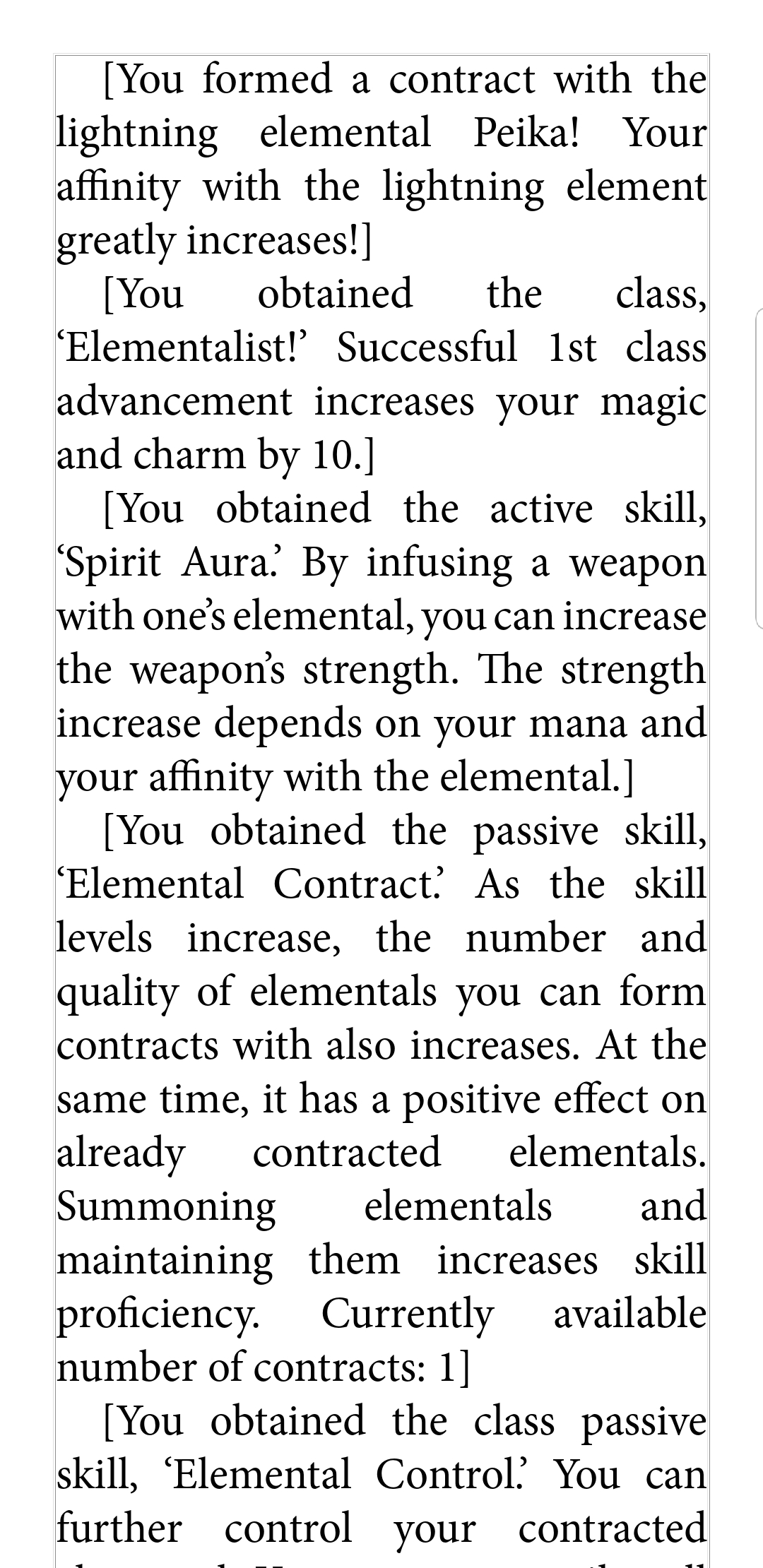

my problem is this
i downloaded some epubs and found the following problem
there is a border around some texts and when i read them on my mobile
not all the text shows

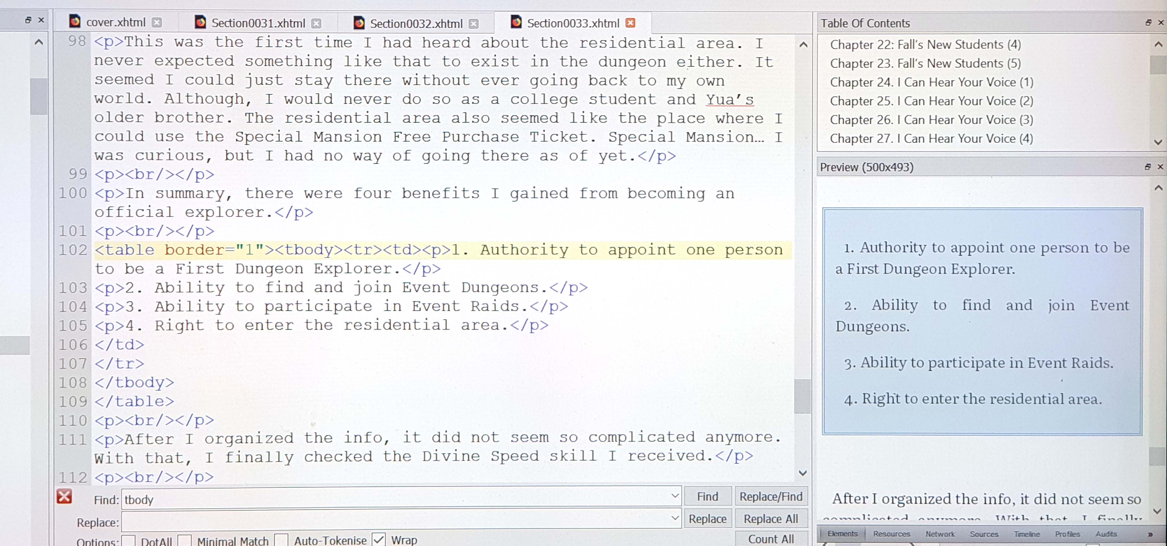

when i open them on Sigil this is what i get
is the a way to remove the border and make it a normal text

it is clipped
it maybe not showing in the mobile screenshot but it is clipped (two
rows are not visible)
as for the code here it is
all i need is a way to remove all the blue rectangles from all the file at once, not one by one

i tried playing with the margins but not working
if you look closely at the mobile screenshot you can see the letters on the bottom, it seems Aldiko is treating the blue rectangles as whole and not as rows
(am using Aldiko on Galaxy Not)

From you snippet of code view it looks like it's really clean **suprised!!**, you just need to adjust the css.
Your .css file is defining a table to have that blue background...you need to find it and change it...
it will look something like this:
table {background-color: lightblue}
or
td {background-color: lightblue}
or it may even have the color as a code like background-color:#f5f5f5 or some combination of that.
