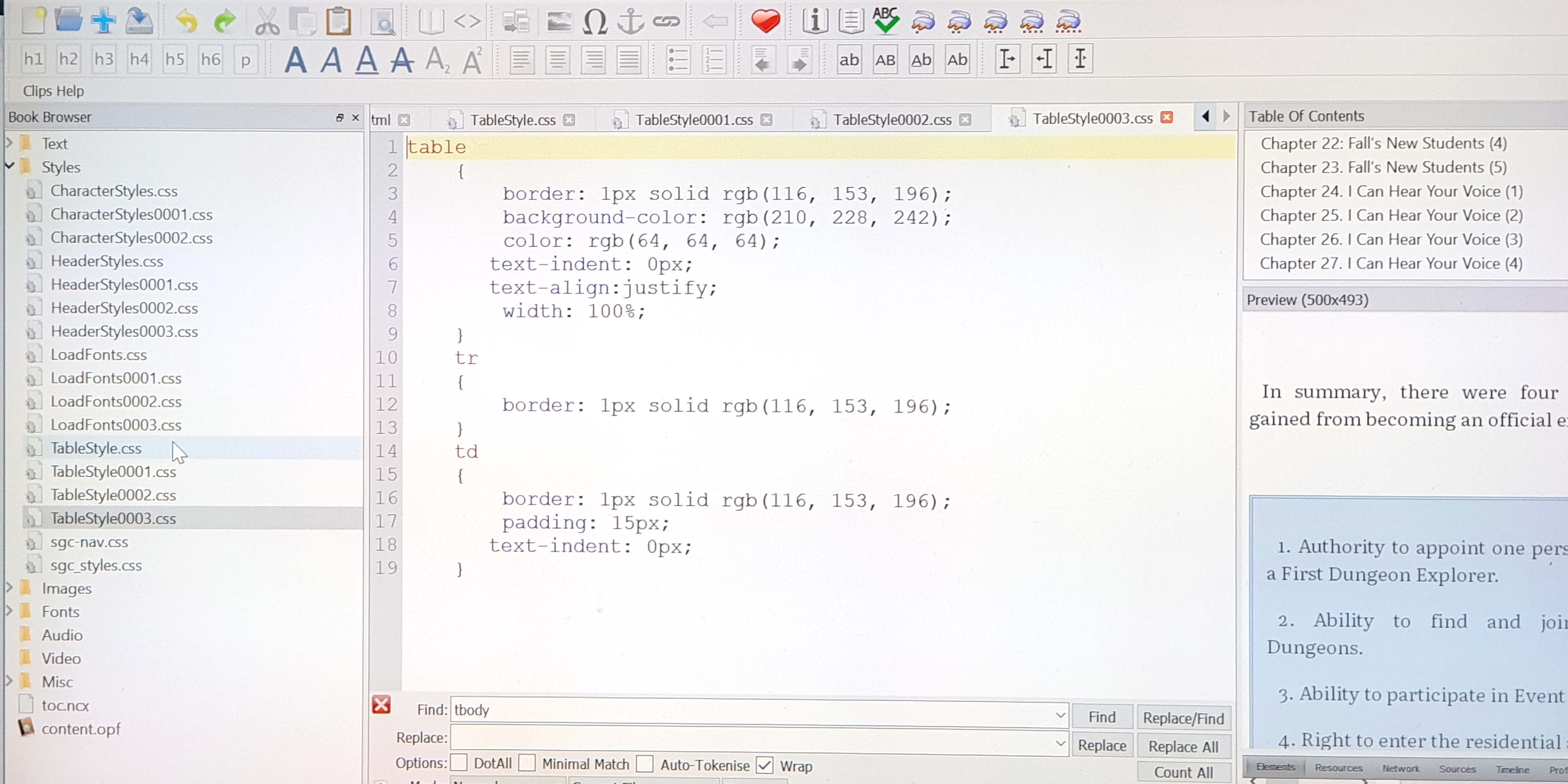

Old 12-15-2018, 11:39 AM   #12
hythamhhl
hythamhhl began at the beginning.
Posts: 10
Join Date: Sep 2016
Device: None
that was very helpful, i really appreciate your help
there is so many css files in the styles folder
and four of them for tables, but all of them has the same code
what file i should adjust so i can delete all the tables from the file
hythamhhl is offline   Reply With Quote
Old 12-15-2018, 02:06 PM   #13
Posts: 31,370
Karma: 62500000
The HTML file will call out the CSS files (yes, multiple CAN be used) for that file.
But Sigil make it even simpler. In the code view, right click on the Paragraph (or encapsulating div) : Go to link or style. This will jump you to the first OCCURRENCE or the top of the CSS if it is not found (where it was supposed to be)
