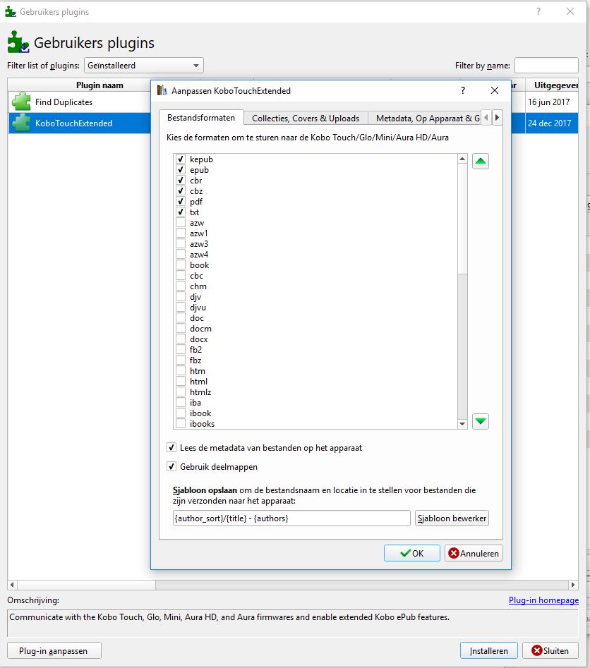

I use the E-reader Kobo Glo and want to put books from Calibre to my reader.Especial Kepubs.
I have instal the plugin Kobo TouchExtended and convert them whit Calibre to Kepub. after i don this i see in Calibre in Formats e-Pubs and Kepubs
But when i put them in my Reader i only get te E-Pubs no Kepubs.
So my question how can i get the Kepub in my reader

When you right-click on a book in Calibre select "Send to device" then "Send specific format to." Then select the format you wish to send.

Check the settings for the Kobo TouchExtended plugin. Make sure kePub is checked and at the top of the list order. Also make sure the regular Kobo Touch plugin (& any other Kobo device interface plugins you might have) is disabled.

Whilst the others have answered, exactly what version of calibre are you running? The reason I ask, is that the built-in KoboTouch driver has supported sending kepubs to Kobo devices for a long time. In fact, the default configuration is to prefer them. If the library has kepubs and epubs, the kepub should be sent instead of the epub.
And the reason the KoboTouchExtended driver exists is to convert epubs to kepubs when sending the book to the device without the need for the kepub to be in the library. Again, if the kepub already exists, it will be sent, but, the conversion should happen for other books. There is an option in the driver to turn this function off, but it is on by default.
The things to check are:
  • In the driver, is "kepub" in the list of formats the device supports? And is it above "epub" in the list?
  • In the settings for the KoboTouchExtended driver, is "Enable Extended Kobo Features" checked? If not, you probably want to check it.
  • Is there DRM on the books? If so, do you have "Upload DRM-encumbered ePub files" or "Silently Ignore Failed Conversions" checked?
The above should point the way to fixing things. And, if you are running a very old version of calibre, you should upgrade it to get the correct support.

this i can find i have the Dutch version of Calibre

I have put some books in my reader and now i can see Kobo Epub. i presume this is the now the Kepub

That is the latest release and is fine.
That shows that if you have kepubs in the calibre library, they will be sent But, the other options are on the fourth tab of the dialog.
Yes, that means the books are kepubs.
