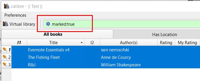

I don't use the mouse, I use the following keyboard shortcuts
Name:	0  Mark Books shorcuts.jpg
I marked some books with Ctrl+M
Name:	1 marked books.jpg
I searched for (Showed) marked books with Ctrl+Shift+M, and selected them all with Ctrl+A.
Name:	2 show marked books and select.jpg
Now I can action the three books -- send, save, remove, add a tag, etc, etc.
